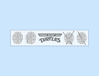

https://easel.inventables.com/projects/EjgIIB3DyYF-qVGXc4Ywxg

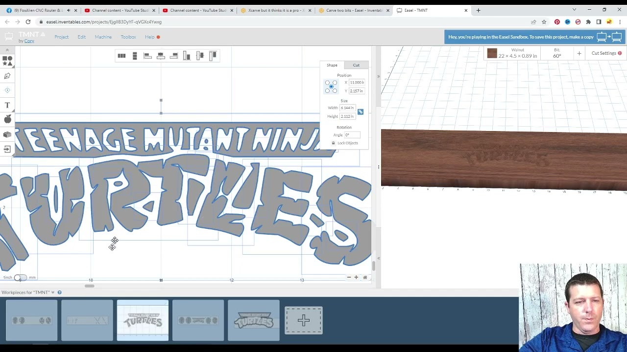

BUT since you provided the link and wanted my input, I made a little video of what I might change (mostly cause I knew I had a clean logo) . . .
Here is the video:
Here is the Easel Project: (I think I went too fast for easel to auto save to it was not letting me save at the end, so all of the bit settings of this project are not right, you’d want to set those up correctly for yours, but at least I was able to copy over the different design with the shallower depth for the shells, the combined parts, and my version of the TMNT logo)

Wow I never expected a 18 min tutorial, amazing. I learned a lot just from that.
Yeah for sure that was an image trace. I was trying to find a svg file of one but I just ended up with the image trace one. I Like what you did with the logo there. I will work with this. My end goal was to fill it in with epoxy that’s why I had it so deep in the shell part, I did get one shell done and filled with epoxy, thought it was a bit too deep so I will adjust some of those depths.
Again thanks for showing me all that that’s awesome.
