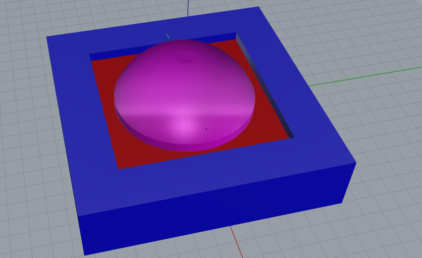

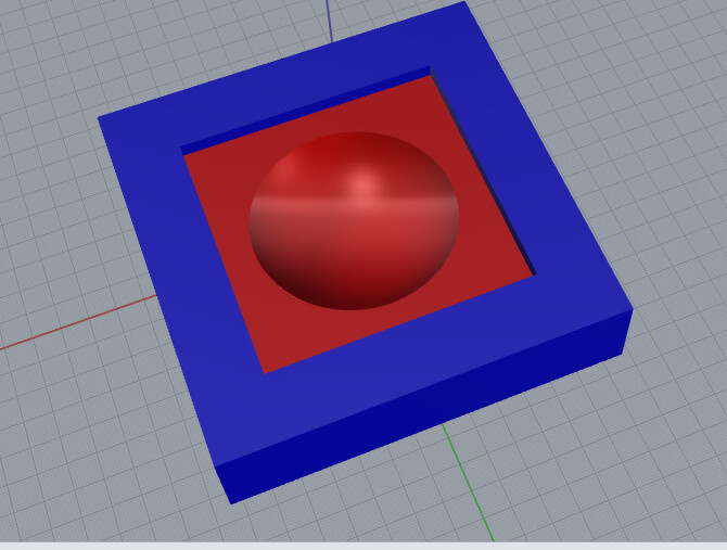

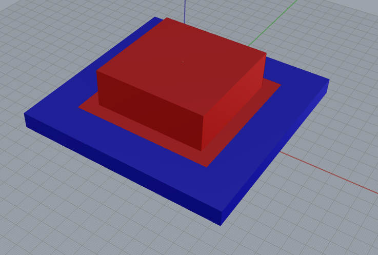

Make a box frame to hold a square of wood and hold that down with good double- sided tape. Then square up your wood blank to fit. Double side tape that face down and carve the back of bowl. Then pry off the blank and flip it over and fasten that down somehow. If the center of the bowl is x0y0, then you should be OK. This is theoretical. Practice all safety rules. Maybe make the blank a little taller than the end result.
This kind of thing..I had to change colors to wrap around what I was trying to show. Making a fixture to hold your work is the key. There are no shortcuts to complex parts. You may need multiple toolpaths to do what you want to do. top carve, back carve,swoop carve, and decorative carves as their own files might be helpful. Once you get that done, then repeating for multiples is pretty easy, which is where cnc is great. I don’t have Easel pro so I can’t save your version.

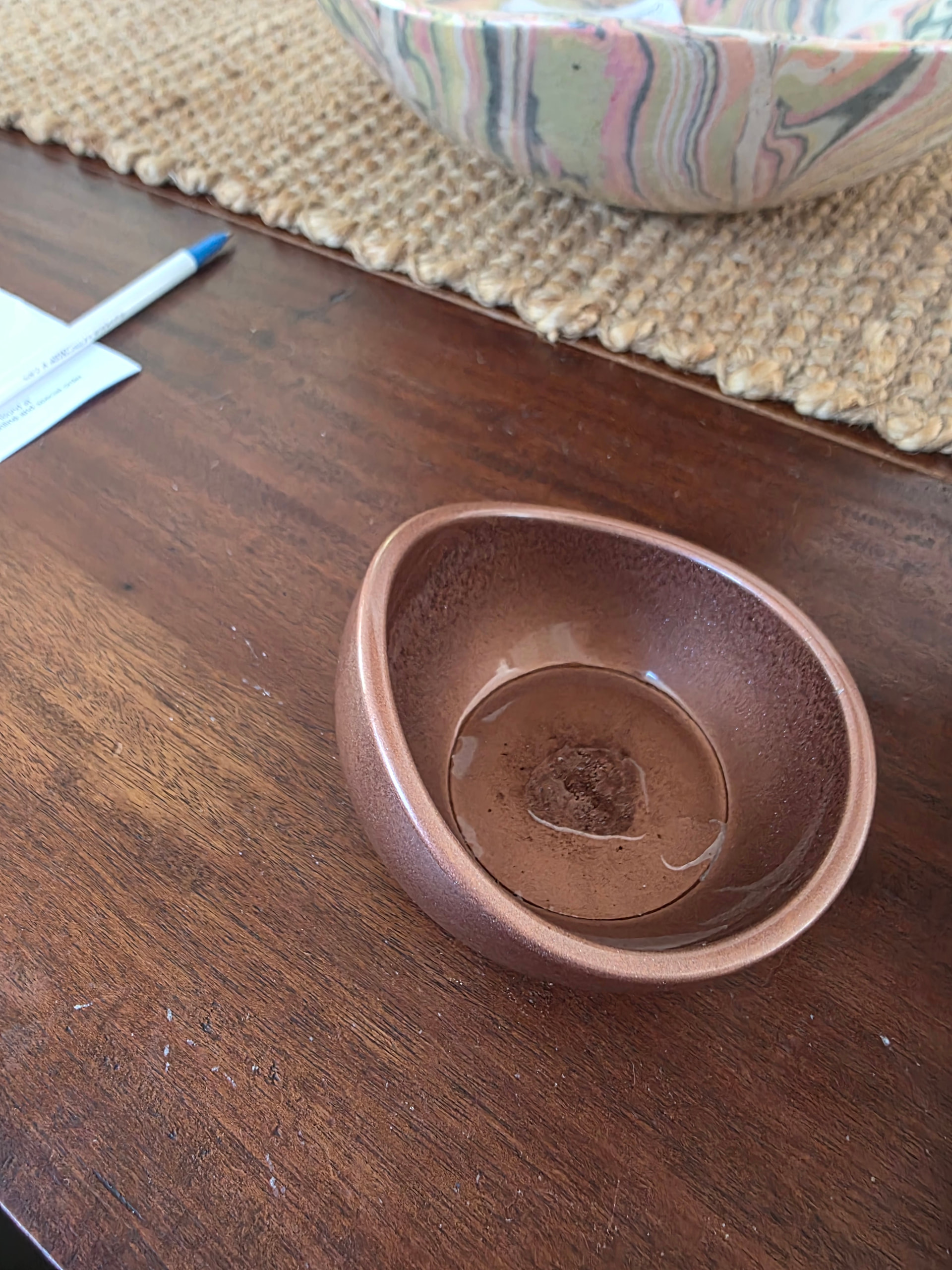

its a resin bowl from a mold
