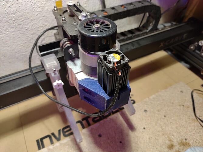

I made a semi permanent mount for my laser.
