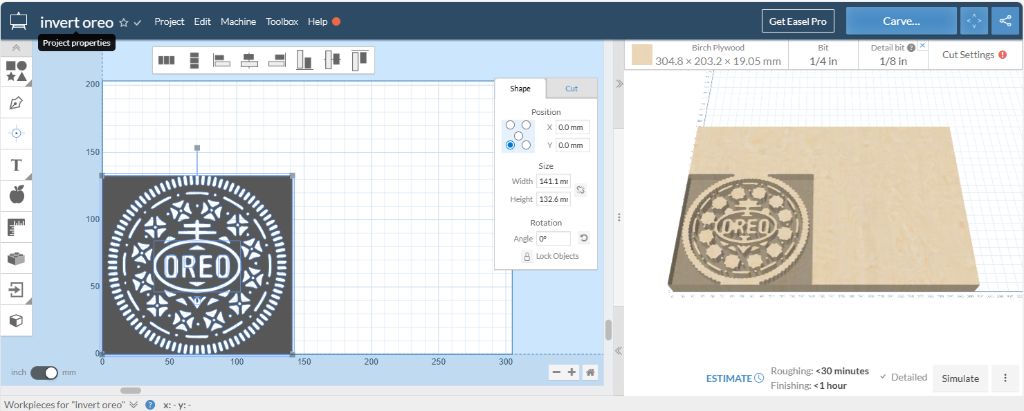

What I did here was copy the Oreo as a PNG. I used the " image trace" tool on the PNG. I adjusted the sliders a bit and then clicked on “invert”. If I were doing something like this, I’d remove the outer waste. Basically I’d make multiple files to cut out a box and make the top separately. Whether you invert or not is based on what you want removed I guess.

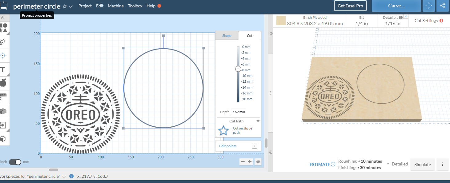

I combined all the elements…use edit tool… and found the size. I made a second Circle the same size. I selected cut on line. Then I stuck one on top of the other.

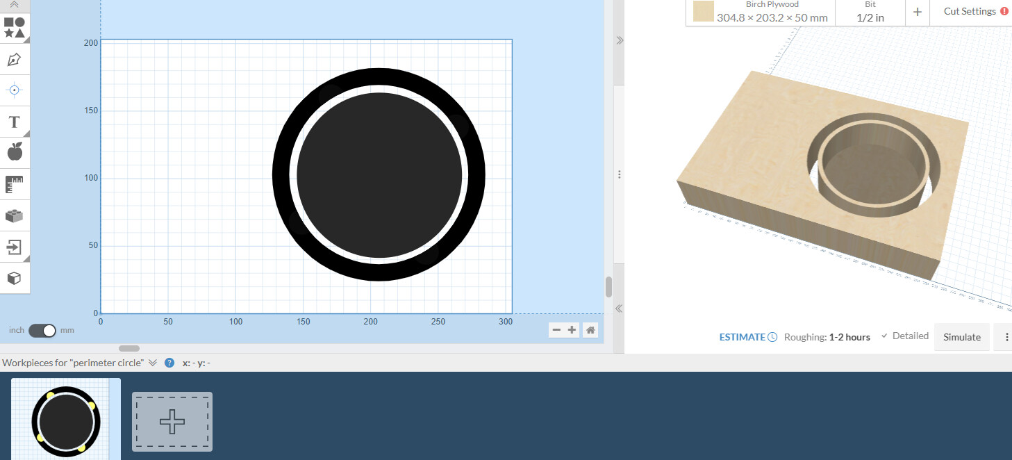

Now for the bottom of the box, I’d use the same size circle as a starting point and remove the middle…etc.
