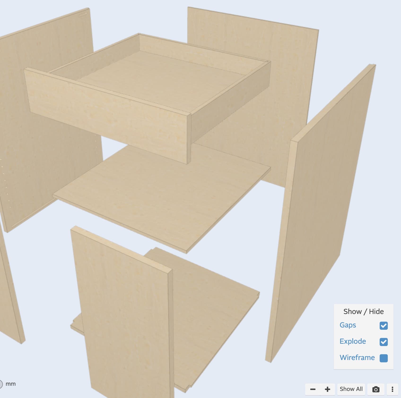

Butt joints
The image below shows an exploded view of the cabinet above with the butt-joint construction method. Users have a number of options to attach the cabinet panels to assemble the carcass such as pocket screws, biscuits, dowels, etc. -
Blind dado
The image below shows an exploded view of the first cabinet above with the blind-dado construction method. The cabinet panels have dados and rabbets that will be cut by the CNC.
