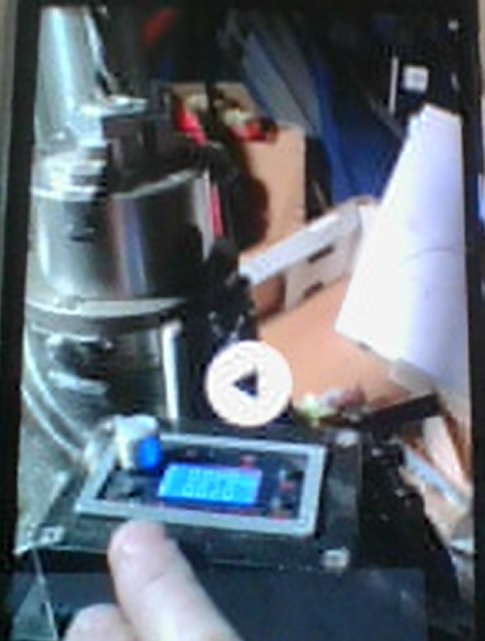

I think that I am a 3D thinker stuck in a 2D world and happy for it. Until I learn more about 3D machining my 2D machines are serving me well. One of my most proud adaptations has been installing a Nema 23 on a 4" rotary table. The SMC02 driver/controller is very easy to use after you get used to Asian english terminology. The hardest think to learn for the SMC02 is deciding on how to use the pre sorted hardware. You can set it to do step movements, degrees,angular rotation, wait time, partial rotating, full rotation and anything in between,etc. One of the biggest features is that there are only 6 wires to worry about. One for each of the 4 fields and the 2 power supply.

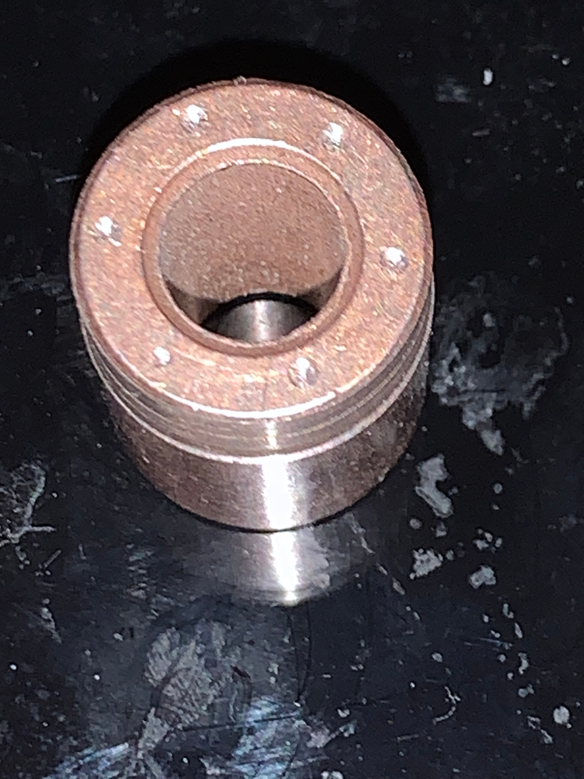

One picture shows my rotary table with controller and one of a bushing that was. Spot drilled as I had to spot and drill hundreds of them.
