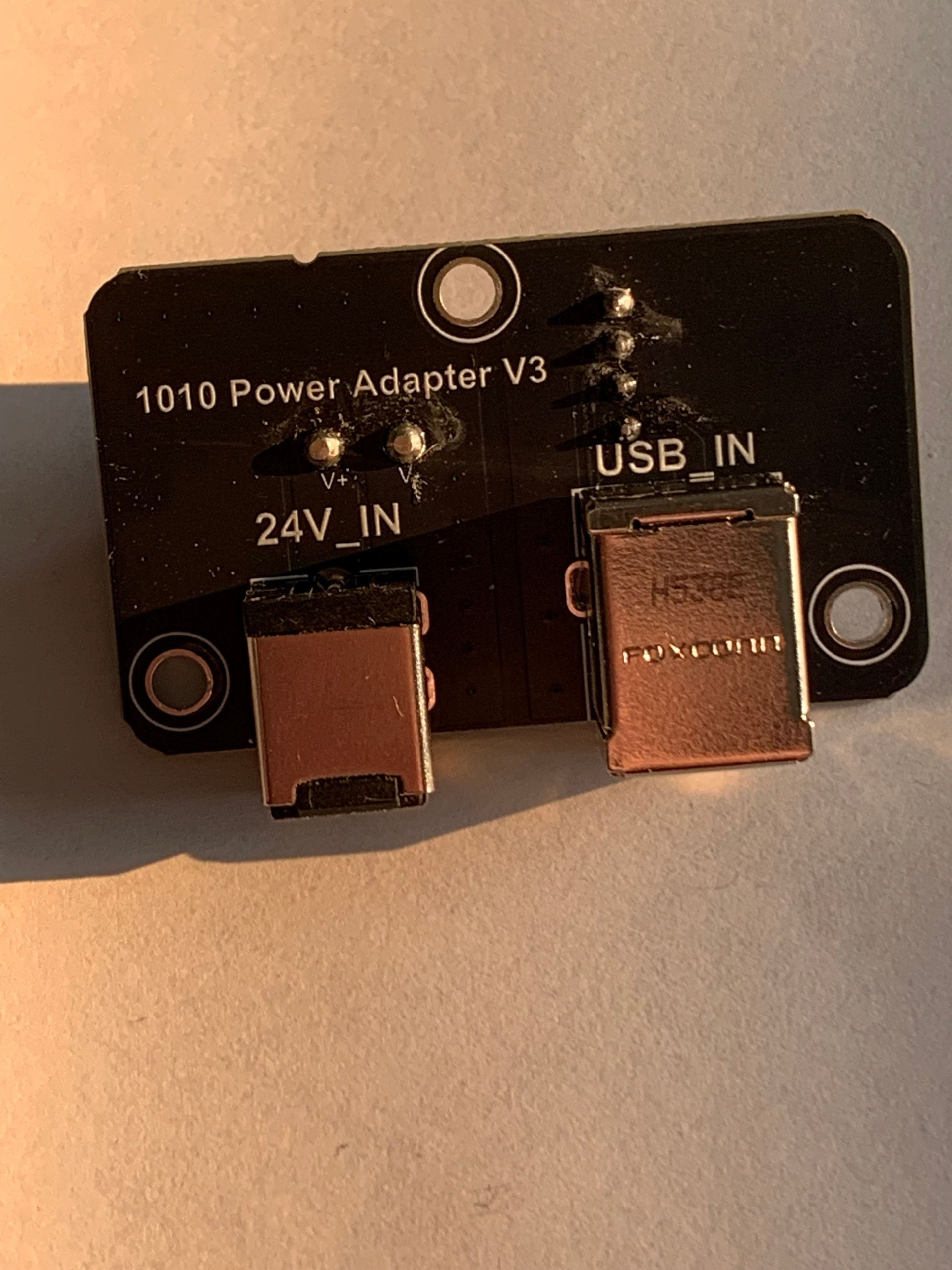

I won a Cubiko from Sainsmart. I was impressed with it until I was showing someone how to use it. The USB got damaged and now Sainsmart tells me that there is no parts available. I am about to revise my opinion from very nice to JUNK. Before that happens I am hopeful that someone might know a supplier that have this power supply from some other source. I really hate to launch this Cubiko into bin 13.
Their text reply to this query and a photo of the part. I have been quoted $200.00 Cdn to have this part replaced at my local computer repair store.
Here is a photo of it.
What is on the back? Is there a component? Maybe you can make a point to point replacement.
Perhaps Join and post this on the Latest topics - Maker Forums. Lots of really smart folks there.
Yes I believe that there are components on 2 sides as it is the 24v power supply. I’ll check tonight. I have contacted Genmitsu directly as I believe that they are the OEM and Sainsmart is a division of them. They also indicated that I am looking at a 4 to 6 weeks for a replacement time frame for this part. I am glad that I have a couple of 3030 and 3018’s that I could use so I am not totally hooped. I miss the days of “it’s on the shelf waiting for you to pick up” and whether I needed a part or an assembly, I grabbed it off the assembly line.
So that photo shows s a 24 v jack and a regular USB that male parts plug into?
Yes

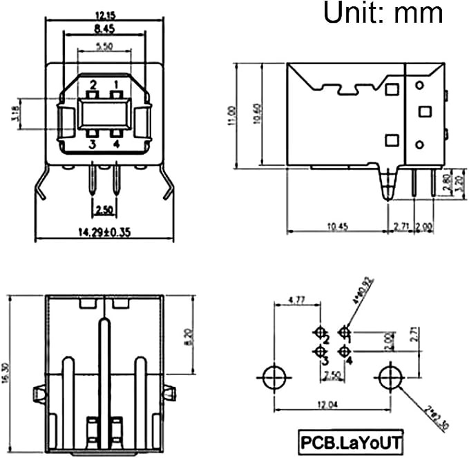

I have sourced this connector and someone who will solder the tiny pads just in case I can’t wait. 96% sure that this is the correct part for this power supply usb PCB.
Uploading: power adapter pcb.jpg…
I’ve been told that there is a plastic tab the spaces the pins apart that breaks off. If I am wrong I really hope someone tells me different.
