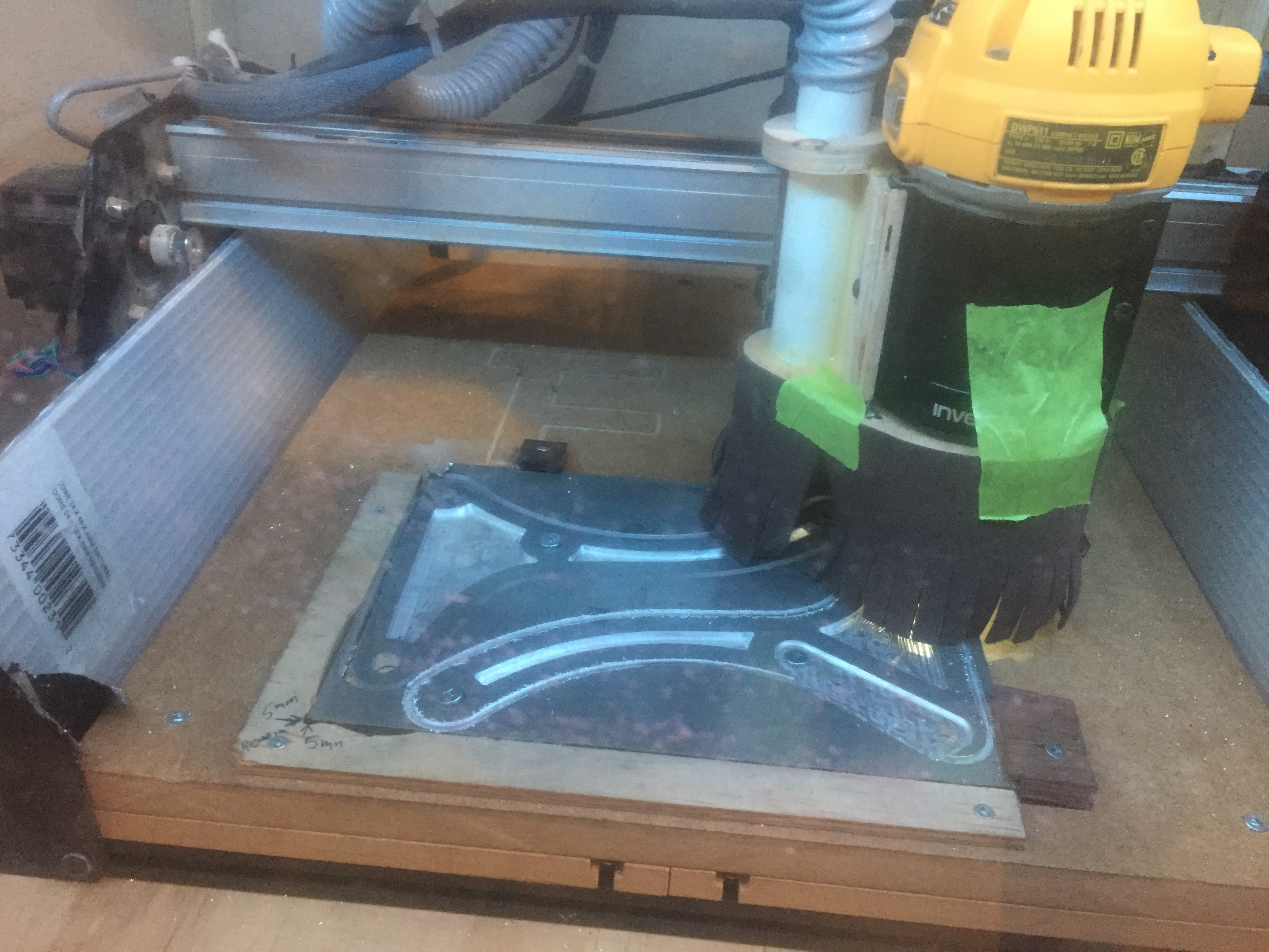

Here is my latest project, an alternator bracket for my car. Cut in 1/4" aluminum, 1/8" 2 flute spiral bit, finished chamfer with 60deg 1/2" v-bit. Designed in Fusion360, imported to Easel for cutting.
500mm/min for bores, with 2-stage so cut centre waste instead of leaving a piece to jam and break the bit (ask me how I figured that one out…). Remaining pockets and cutout at 1200mm/min, .25mm doc. Took maybe 90min to complete.
Machine is 500mm SO2, upgraded to Xcarve with DW611, upgraded again with new gantry and nema 23s when that came out, upgraded again with x-controller, still need to disassemble to change out x-rail with new single extrusion.
I still need a couple longer bolts and spacers, it looks like it will work perfectly.
