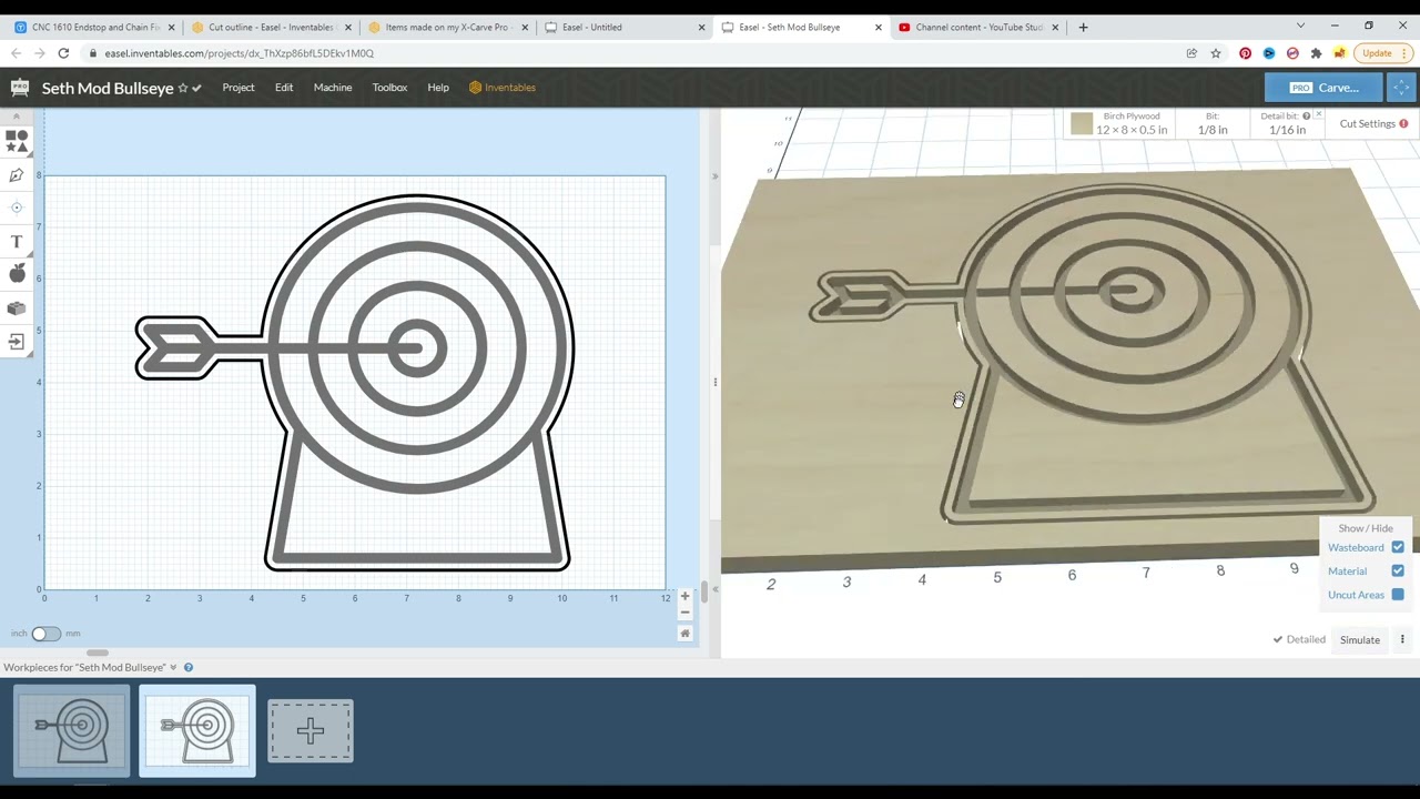

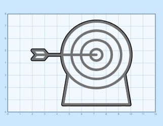

I am working with a bullseye target from design library in which I am cutting the interior 1/4 deep, but I would like to the exterior outline all the way through(1/2). I don’t see a way to create an outline or break a design apart to cut different depths per line. Suggestions? I attempted the explosion app, but it seemed to only duplicate project. I’m a week into x-carve…please advise.
If you can share the project (in easel go n to project>share>change it to unlisted>copy the link>post link here)
I can show in a short video how to do what you need using your specific design element.

Awesome video! Thanks so much for taking the time!! I have already subscribed. I am a corel and trotec user or 10 years and just getting into cnc. Your video was so helpful. Many Thanks!

That is super helpful. I appreciate it. I’ve got to dig up a little raw material and I will give it a go tomorrow. Thanks!!
