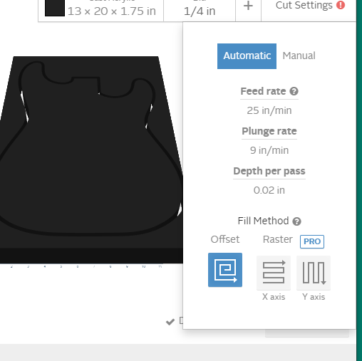

I can only guess that your depth of cut is too deep and your Z feed rate is too fast for the material. Acrylic is pretty hard stuff. Try slowing the feed rate down and don’t go as deep. Perhaps try a larger diameter bit too. Putting a lower number in both Feed Rate and Plunge rate and Depth per pass would do that in Easel.
Change the numbers in cut settings.
