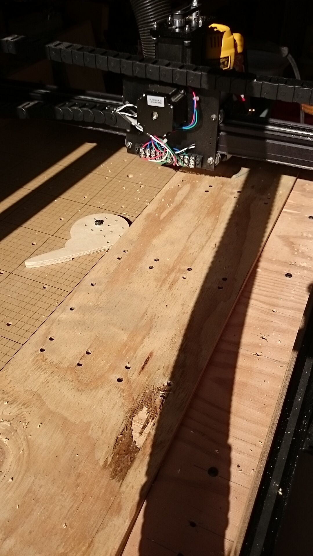

Got a good start on making some new shop cabinets today. This was my first attempt at using the XC to cut joints in pre-dimensioned wood. Looks to be working out so far. I’ve learned a couple tricks that seem to ensure reliability.

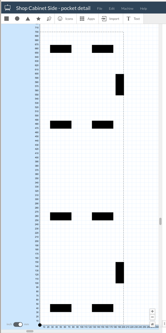

So I redid my test joint project to try and capture your suggestion. I’ll cut it out tonight and will let you know how it came out. I did 17mm mortises and 16mm tenons. I figure I can tweak those values after a test fit. Below is an image of the full Easel project before I split out the dogbone fillet holes into a separate cut file. The project will get cut in half after it’s completed and the top part are the tenons.

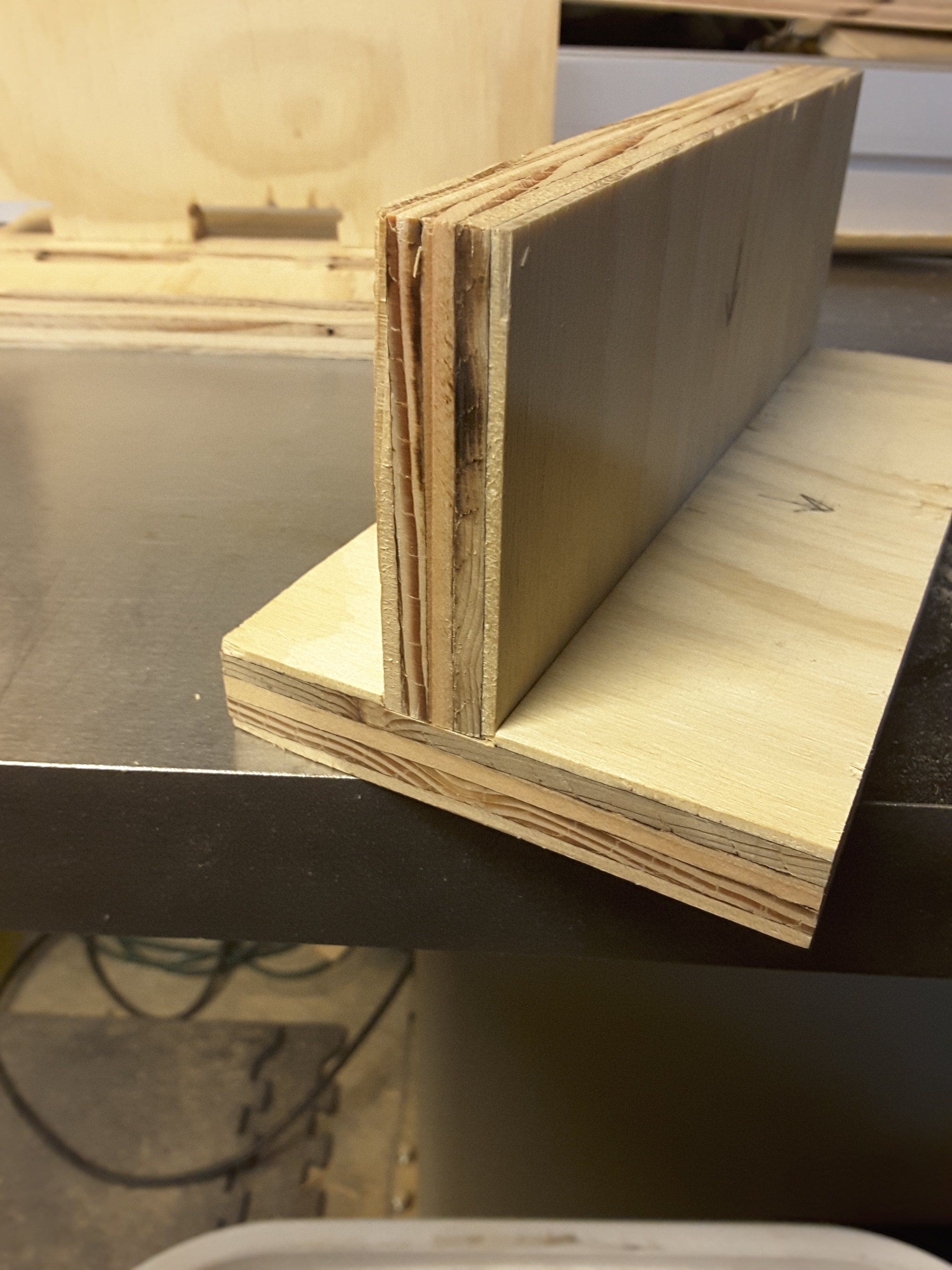

Well, should be no surprise, it works quite well.
I’ll have to keep tweaking where the fillets are, but the joint is pretty forgiving and hides everything nicely.
I’ll update my shelf pattern and will assemble a full unit using this joint on Friday. Looks much cleaner than the CNC Chic one.
