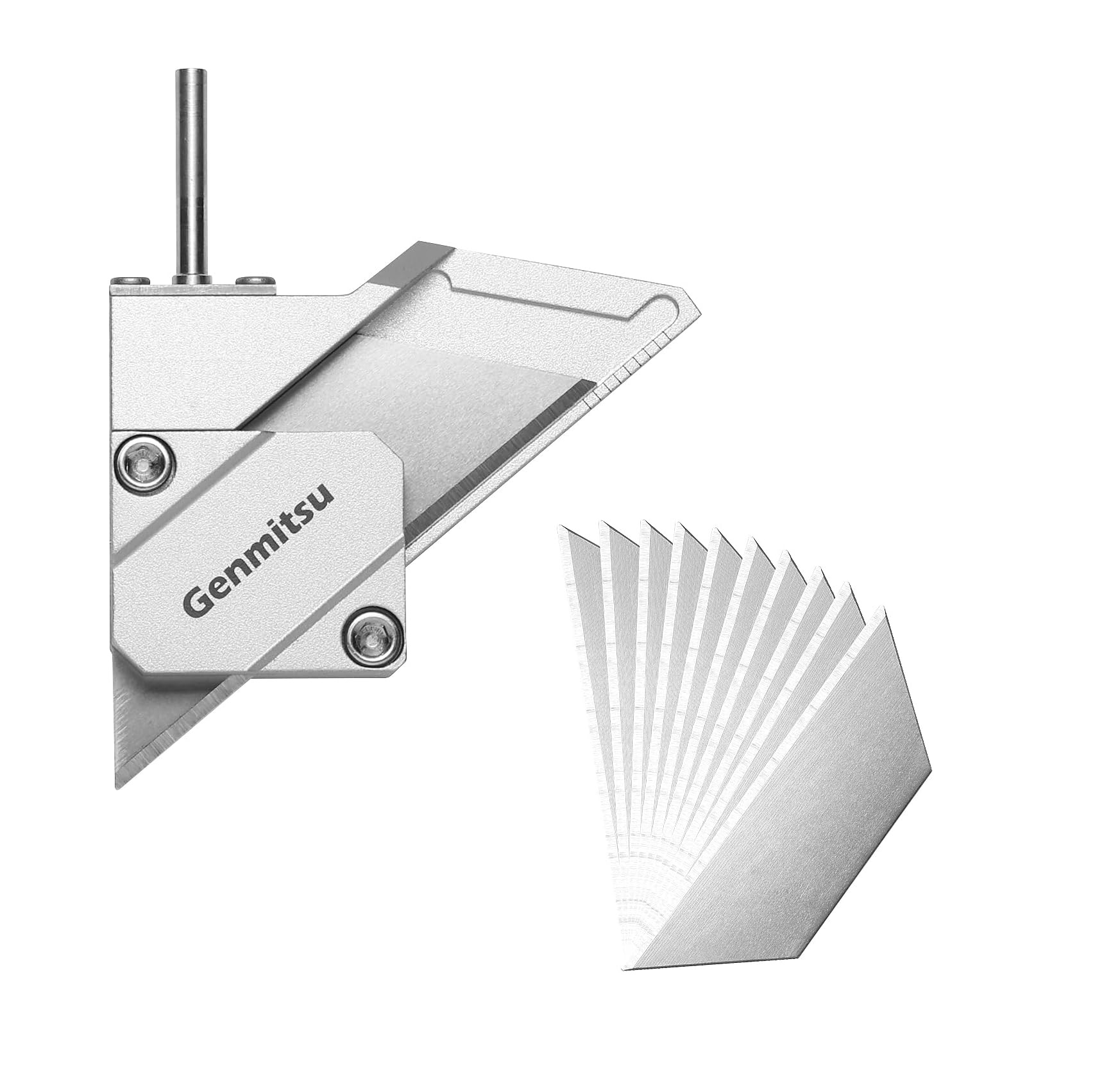

I just order some stuff today and am curious if anybody has done some drag engraving with a cubico. How about experience with their drag knife?
What bits and holder did you use? What engraves the nicest, brass, aluminum, acrylic or? Is one font better. Etc…
I just order some other stuff today and am curious if anybody has done some drag engraving, What bit and holder did you use? What engraves the nicest, brass, aluminum, acrylic or?
I always thought a drag knife was used to cut out thin sheet goods. I have never had the need to use one myself. If I wanted to do engraving, I’d get a really sharp V bit.
