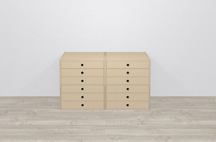

I am trying to make a bank of cabinets with 3 drawers each and have them all equal in height, but it seems it is limited by the top drawer height maxing out at 8" – do I have this correctly or am I missing a setting somewhere? Seems odd!
Also: Drawers are limited to 3 per cabinet?
Def not limited to 3
The software isn’t smart enough to swap all drawer sizes - so if you have something XX height with 3 drawers and 8" is the top, move the top drawer to 2", then add in more drawers and look at those sizes. As you change the top drawer height the bottom ones will move in relation to each other and the top.
Thank you! That trick worked for adding more than 3 drawers, however, I am still stuck at the first drawer being a maximum of 8" – any work around for this that you know of?
Yes, you have to be in the “All cabinets view” and then you will have an option called “Front” in there you can select the top drawer height
Yes, thats where I cant get larger than 8" for a front…
maybe 8" is as big as it goes it it may be tied to box size - try to increase the height of your box and see if it lets you go bigger.
No, seems to be a limitation in the software, as far as I can tell.
yeah, I made a 72" tall base cabinet with 3 drawers and was limited to 8"
Have you found a work around for this? I am running into the same issue.
It is now in the list of stuff that is coming, but it just got put in last week, so probably not “Soon”
