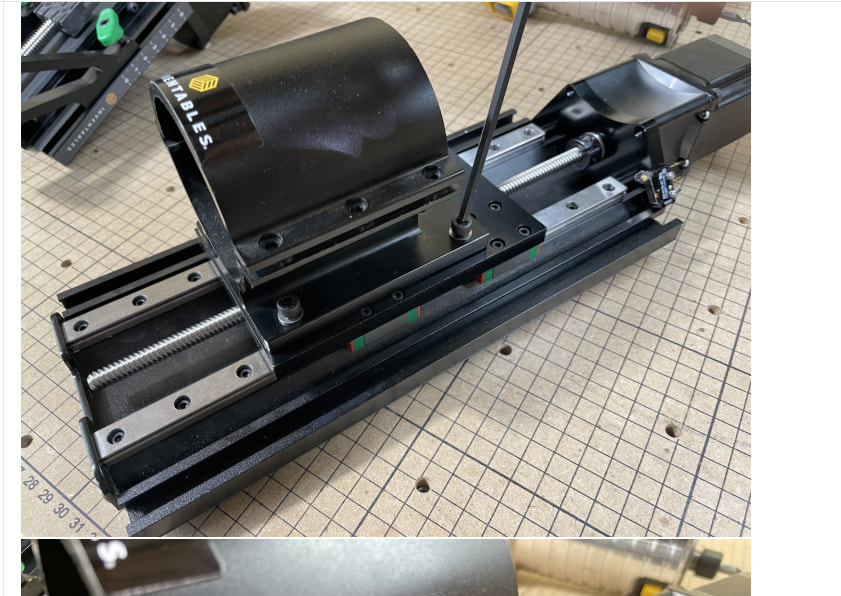

Whenever I home or move the spindle carriage, it’s loud and vibrates more and more as it reached the top. Is this normal? See video…

Inventables New 2021 X-Carve Z-Axis & Spindle Assembly

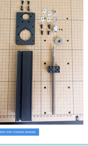

I can not say for sure but I suspect that it is a machine threaded rod for a lead screw and not an recirculating ball ball and nut. This rod should have a fixed bearing top and bottom.
My original Shapeoko2, the forerunner of the X carve only used a top plate and bearing, and IIRC correctly the X carves shipped with a similar setup, an acme screw though an anti backlash nut. The cnc 4 newbies have upper and lower plates and bearings. The Z with a top bearing works fine, it’s just you get that wobble.
The OP’s must be the upgrade with linear blocks on the rails.
