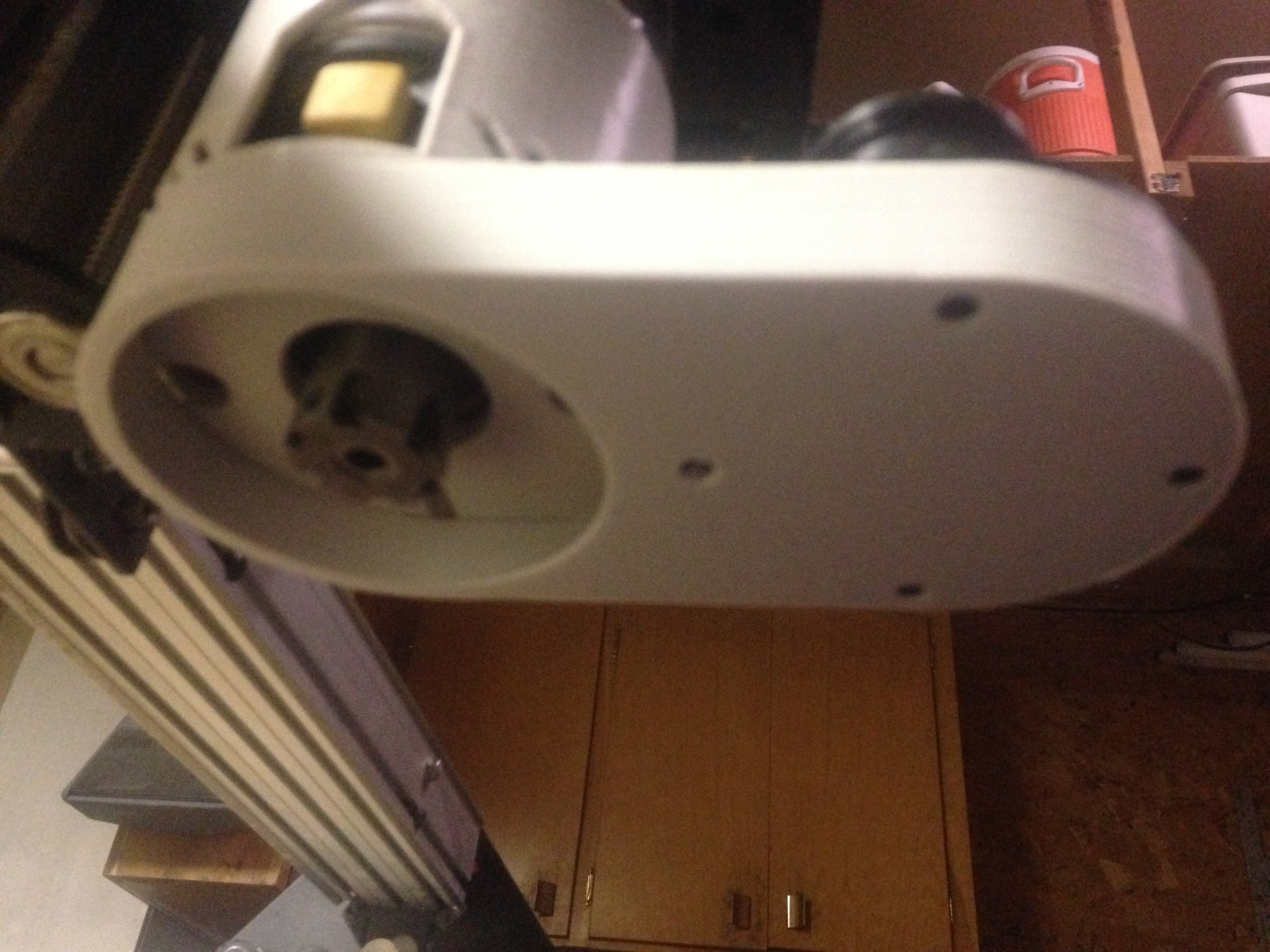

The collet actually hangs slightly below the shoe since that will ensure the shoe can’t hit the material if you cut to max end mill reach. If it causes issued please let me know and I’ll try to modify the height.

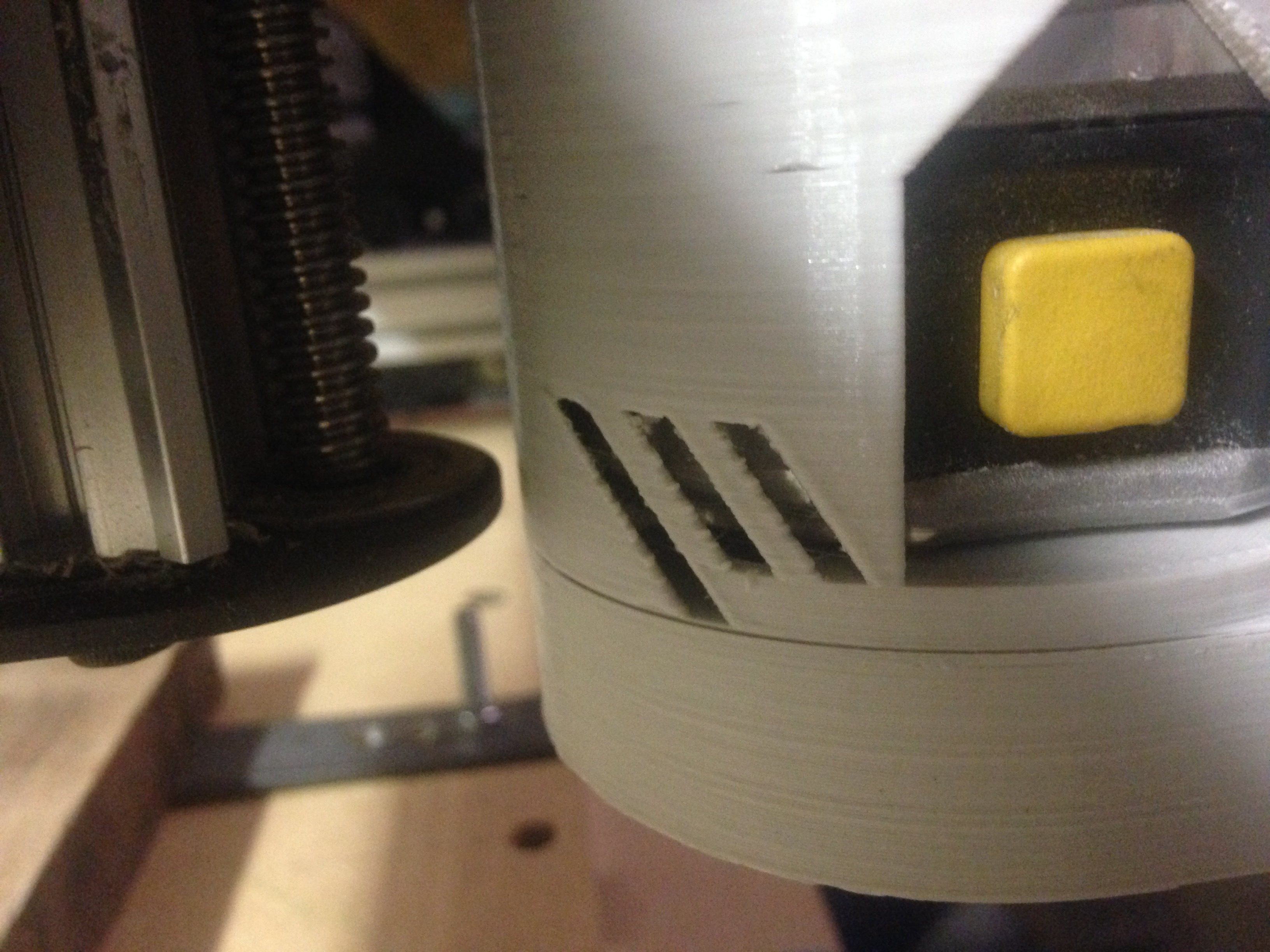

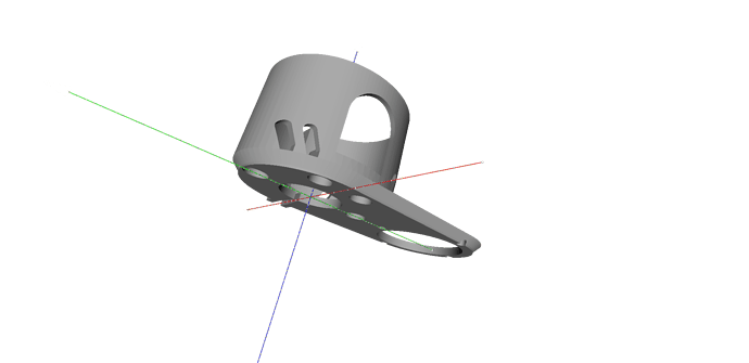

Uploaded a new test version of the upper plate and clamp. It’s been shortened by 10mm and the vents and access port have been rounded off to improve print quality. I have not had a chance to test print. If you are able to print, please provide feedback!
