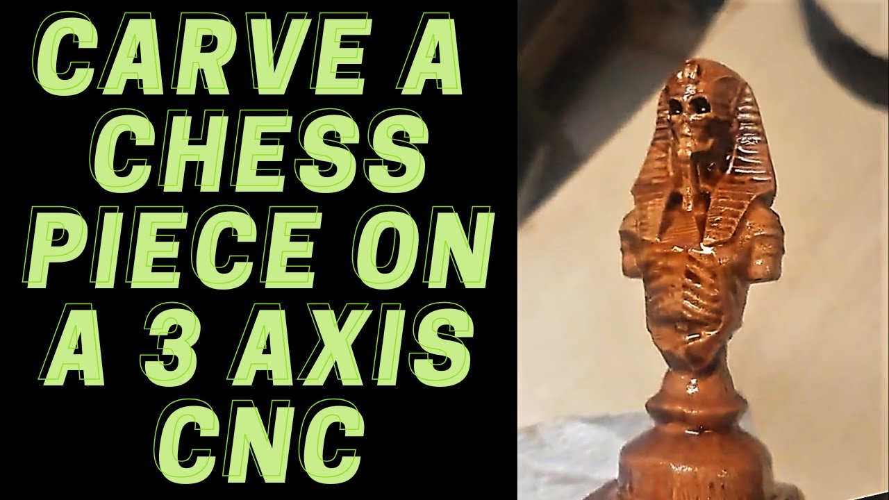

The way that I’ve seen others make chess pieces successfully on a 3 axis machine is by CNCing one piece at a time, and carving all 4 faces. . . Like this

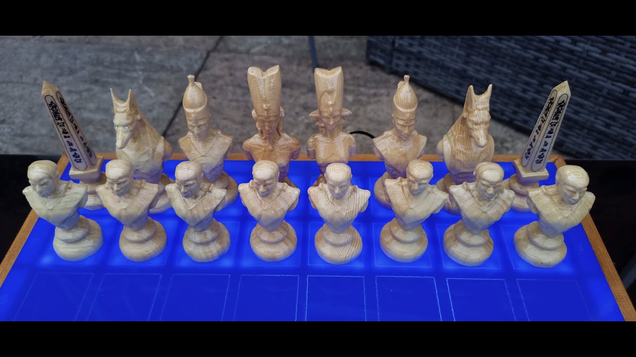

OR this
