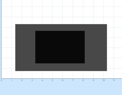

I think I run into the tiling bug too, but with another scenario, which doesn’t include a pocket inside a pocket. See shared project:
When simulating the first (lower) tile it starts by plunging into the workpiece way too deep at the upper left of the tile. This can be seen easily also by investigating the start of generated g-code

Sadly I realized this too late and my 3018 CNC did a very ugly, almost 6mm deep cut with ~760mm/min and some missed steps on the z-axis; fortunately nothing broke just before I aborted the job.
I than turned to manually tiling my job and all cutting went as it should; so this behaviour is clearly triggered by enabling tiling.
As the last response to this discussion is already very old maybe the shared project can help further to investigate and solve this bug.
