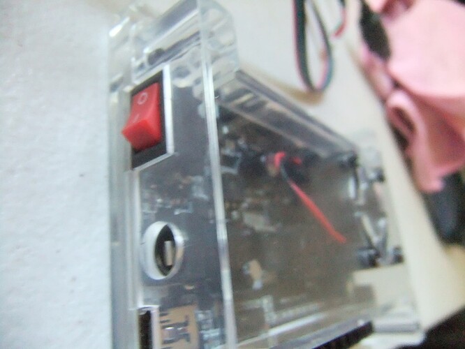

Hi Brandon, I’m very happy to write I have finally fixed the bug although I don’t know exactly what was the problem. I ordered another control board ($50) and was happy to pay that to finally get the machine mobile again.
I want to thank you for your help, it was appreciated and again thanks for taking the time to try and solve the problem.
Kind regards Col
Not a problem!!
I am glad that you were able to get the issue resolved. Out of curiosity, do the control boards appear to differ in any way (i.e. different size capacitors or other different components)?
