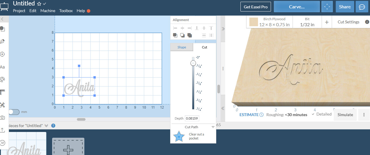

hello i need some help please want to make fine/thin cuts or ingraving but only do thick change bit size dont work
Well I would say you need to select a bit with a more acute angle and set the depth to obtain your desired width. Maybe something like this: Buy Whiteside Carving Liner CNC Router Bit, 5/8" Point, 1/4" SH at Woodcraft

When you make a design the lines it looks so thin thats how I wants to cut/ingrave but all the cuting opstions make it so thick is there something i do wrong smallest bit i tryed was 1/16 but
Well, you can also find single line fonts, but I don’t know if Easel supports that or not. Try a shallower depth of cut first. Material choices can also impact the results too. Basswood as an example might show a smoother result than some other more splintery timber. Apparently Easel Pro will allow single line fonts.
