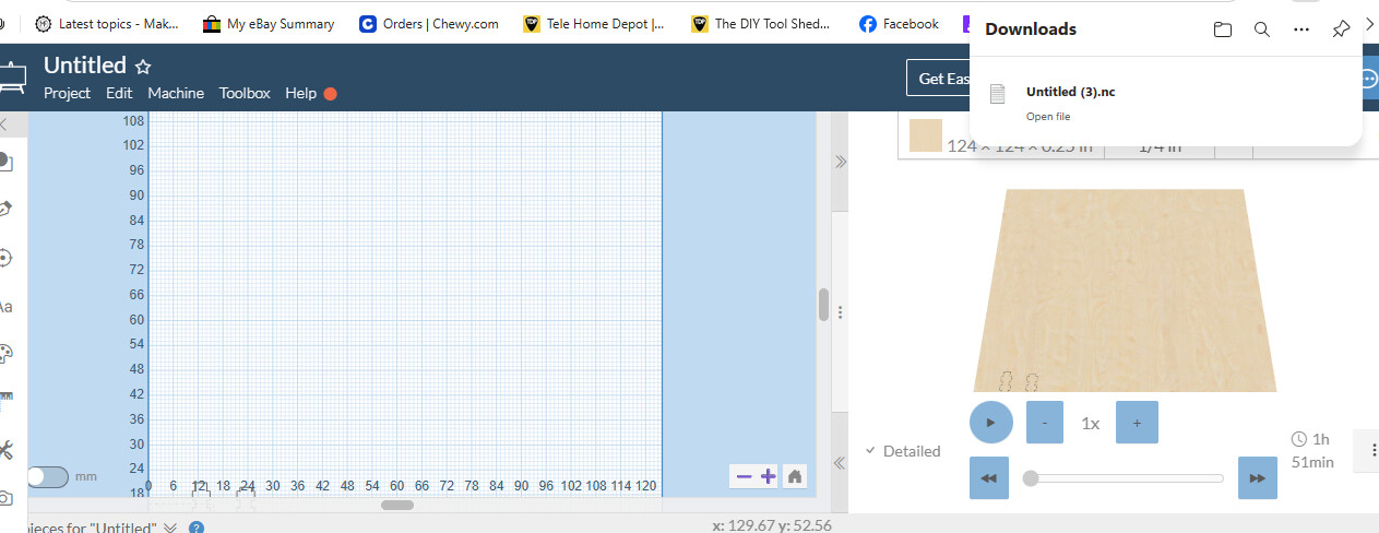

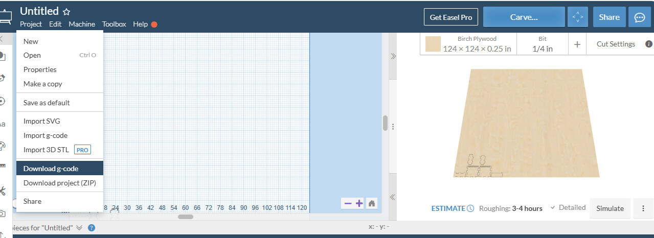

For the record I use the Universal Gcode Sender after saving the Easel Gcode to a drive. 2 bit carves show up as two separate files, I’m gonna guess that after it finishes the rough carve it goes back to work zero and showing some type of prompt to start the finish file.

You can save your file as gcode which is text. You can open it in text editor like word or notepad. Look at the last couple lines of the roughing section. The Z will go up and then it’ll move the router most likely to X0Y0.
