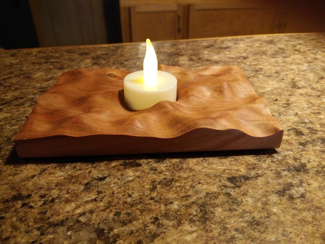

Was looking for something quick to do this afternoon, and something the Mrs may actually want around the house
Decided to make a votive candle holder out of some scrap cherry.
I made the 3d model for this in Autodesk Maya, tweaking their ocean shader, and converting that to displace mesh.
Used a 1/4" ballnose for both the roughcut and final pass, toolpath generated via Meshcam, sent to the X-Carve via Chilipeppr. Whole cut took 40 minutes.
I’m pleased with the results. Slapped some light stain on it, and the grain really popped.

Made another one this weekend. Pretty rewarding to spend 60 minutes in Maya, and 60 minutes on the X-Carve:

I modified the original to not be as high and have slightly rounder waves, and that took way longer then 60 minutes for me to modify the file. Memento was used to bring into fusion (quads).
CAM takes like 10 minutes for me. 47 minute cut time, and very little sanding.

Instead of sanding, what stepover are you using? Drop the stepover and the lines/banding will get smaller or disappear.
Agreed, I’m just trying to keep my cut times down right now. I’m using a 1/4" ballnose with a 1/32" stepover. I could drop it to 1/64", but I have a feeling these will jump from a hour cut to say, 1:30. Isn’t the end of the world. But if I have to sand for half an hour it’s a wash
I presume there’s some sort of standard formula for stepover when it come to ballnose bits, since the curvature should be roughly the same? I’ve yet to go researching on that yet.
I tend to use 40% bit diameter step over for roughing and 10% bit diameter step over for finish cuts.
These were the default setting in VCarve and I have stuck with them.
I used a 1/4" ball nose for the entire thing. I used a parallel with 115in/min feed rate .01" stepover for final pass.
For roughing I used 3D adaptive with 70 in/min .089" optimal load, .09" step down leaving .02" for final pass.
Granted I am using a Shapeoko 3 so feeds may very, I had a Shapeoko 1 for the longest time. The key to the fast final pass is running parallel to the X axis ie left right left right. You will have more rigidity, especially if you have the double makerslide.
