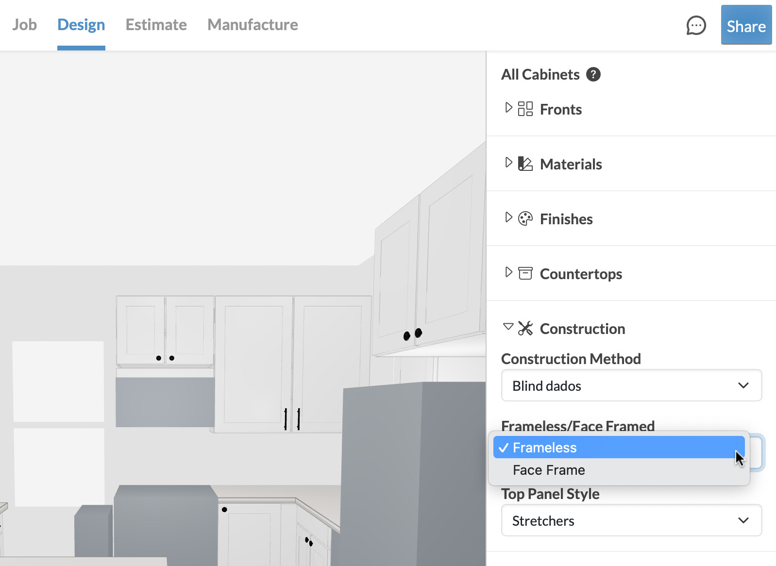

Hi - I’m trying to make some closet shelves that don’t need face frames.
I’m having trouble finding the option to make frameless cabinets.
This used to be possible at some point, but I think it’s been lost.
I know I can just oversize the depth of my cabinets by 3/4" - but that feels pretty hacky.
Hi @MasonTejera, the option you’re looking for is under Construction. Currently it applies to all cabinets in the design and is only available when you don’t have any cabinets/appliances/etc selected.
I’m having the opposite issue, I can’t find the face frame option. Under “Construction Method” the only drop down menu I have is for butt or blind dado
Hi Tim,
There should be another drop-down below “Construction Method” called “Frameless/Face Framed”. It is only available when you don’t have any cabinets/appliances/etc selected.
