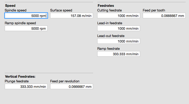

How did you guys determine all of the data for “Feed and Speed?”
Do you let the program auto populate the data of is this something we have to figure out and play around with?
