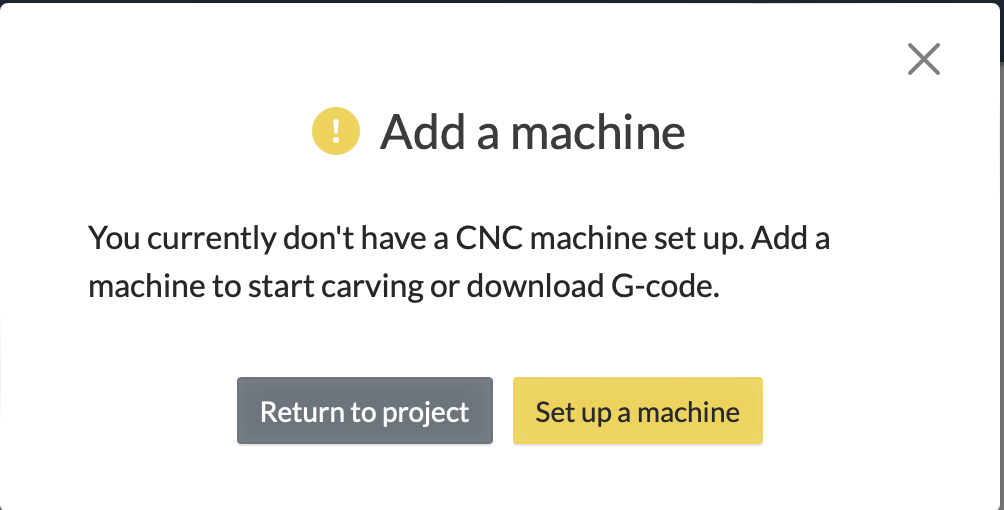

I fired up Easel just now to export a project I have been working on and a popup appears to add a CNC machine with a ‘Return to project’ option or a ‘Setup machine’ option which I don’t need or would like to bypass as my machine is not listed and In the settings window.
I have never seen this popup before. How can i just get the G-code out now?
So / Project / Download g-code is no longer a simple export.

And I just worked it out.I just put dummy settings in the set up window. All good.

Hey Jeff - Easel was requiring machine setup before allowing G-Code export. My Machine wasn’t recognised in the settings to bypass this step so I just added a fake machine.
Easel must have updated it’s browser version and wasn’t allowing G code export without first setting up machine type. I couldn’t bypass this setup step even though it said you could do a straight export. My Machine wasn’t in the setup process so i wouldn’t let me export.

Jeff, I’m curious why setting up a machine profile and downloading the Easel driver is now a requirement to downloading GCODE
I can help answer this. If your machine uses a GRBL-based controller, the machine setup process also involves testing the movement of the machine. In order to connect to the machine to your computer to control its movement, you must have the Easel driver installed.
