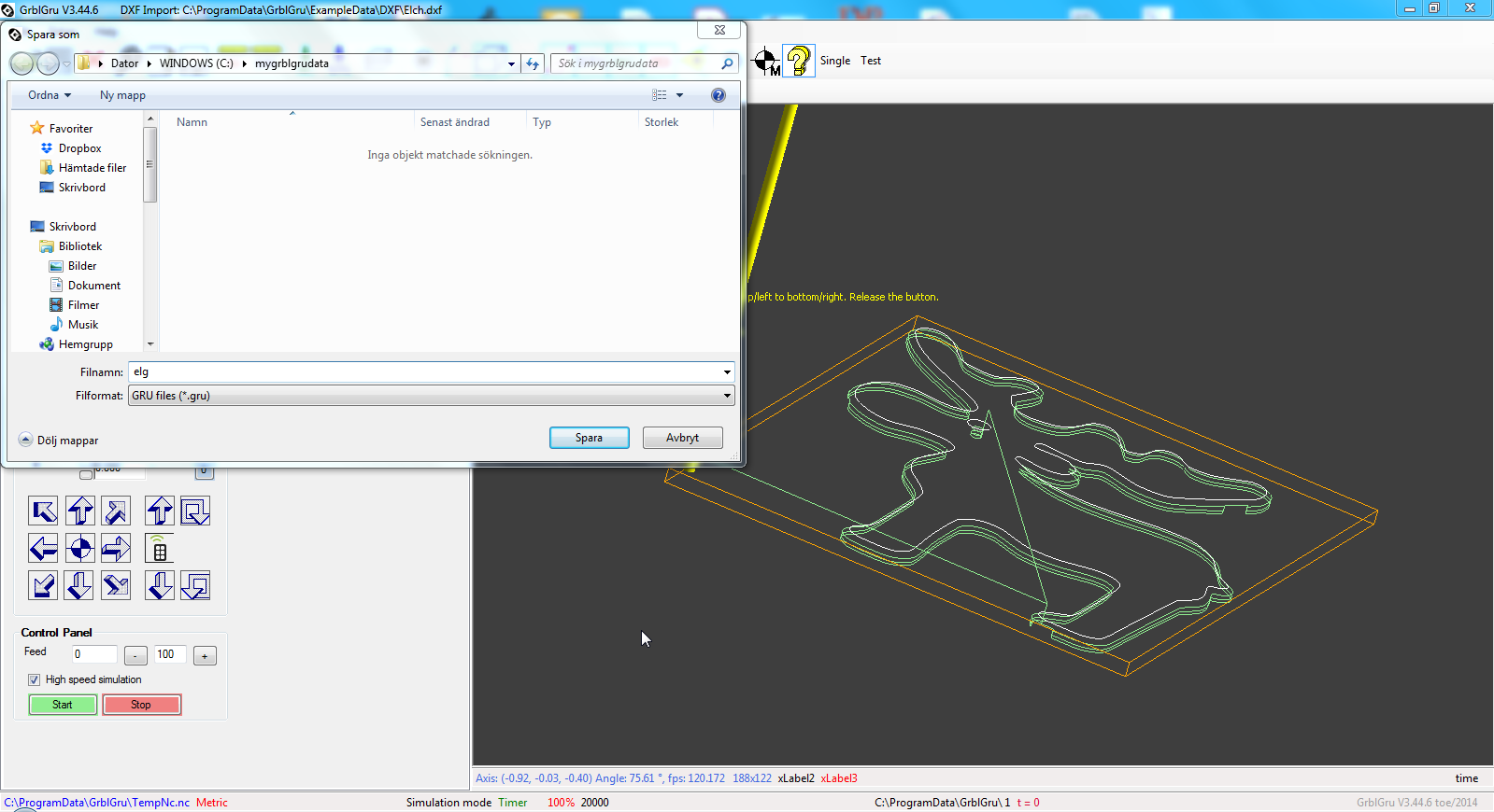

When I try to save a project (Your Elch example project ) I get an error so it was not possible to save (see my two files), what is wrong .

Thanks for your feedback. Sorry, at the moment I have changed a lot of internal things in the program. Therefore the last beta versions are not very stable yet.
I just uploaded a new beta. Hope this is a bit better. Maybe you’d like to try it again.

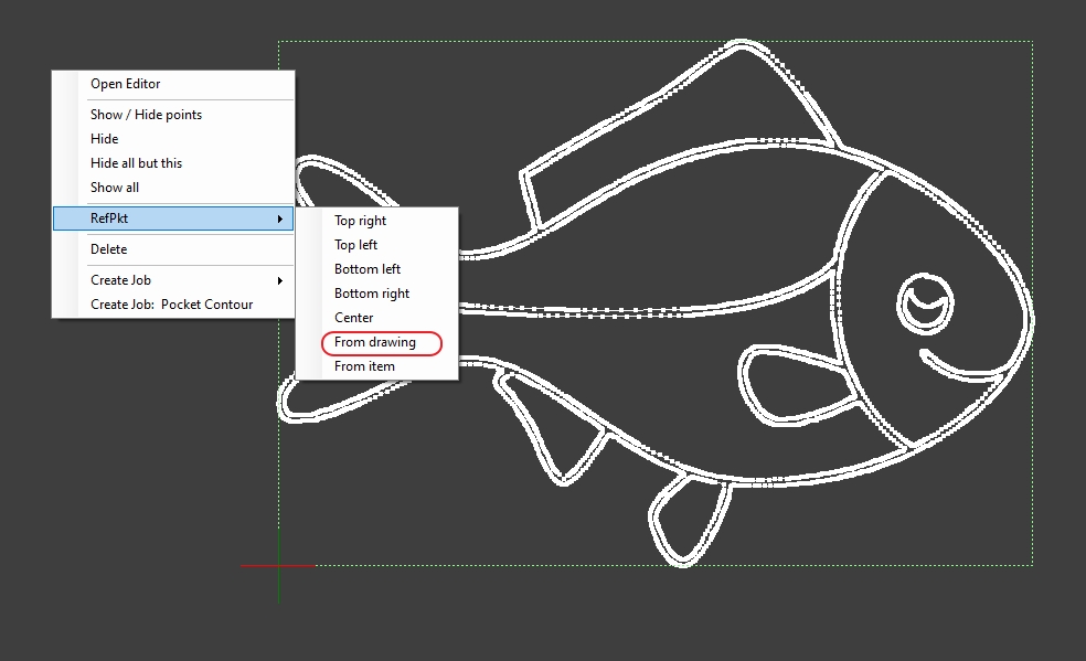

I would like to set the XY Origin to the lower left corner of my stock/workpiece instead of the lower left corner of the imported DXF file. Is that possible?

Unfortunately there is no possibility to set the reference point to the stock dimensions.
A possible ‘work arround’ would be to draw an additional rectangle in your DXF drawing with your exact stock dimensions. You can also set the reference point of your drawing to any point and then select ‘From Drawing’ from the context menu. (see pic)
Maybe it would be better to provide inputs for the stock dimensions in the future. Then it would make sense to refer to the reference point.
