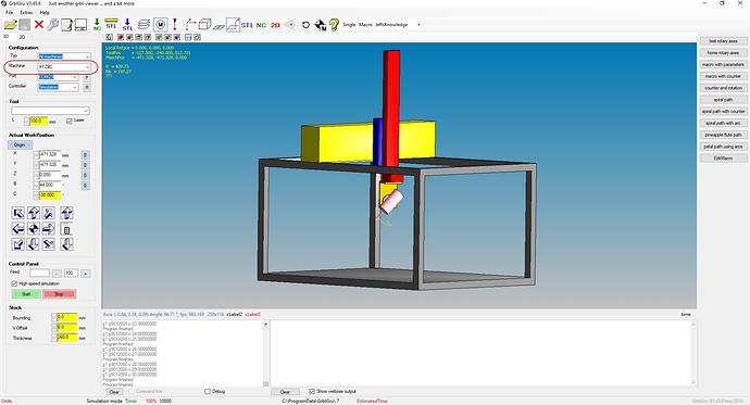

@Matrix
I have uploaded a new beta version V3.45.6. There is now a new machine type ‘XYZBC’.
Please let me know if there is anything missing.

On my machine postprocessor, the A axis is your B axis, roll under C axis, there
is any away to change this on GrblGru?
Thanks

first of all thanks again for your help to improve GrblGru.
I have created a new machine type “XYZAC” in the new beta version V3.45.8
This should be better for your machine.
I have also fixed a bug in the simulation. But it is hard for me to analyze the GCode
because I don’t know how the right tool path should look like.
It would be great if you could also show me the target contour.
Thanks
