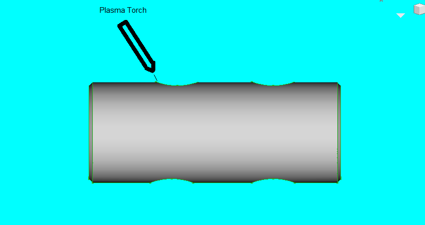

There’s a plasma tube and plate cutter that almost do what I need. The vutter Head must rotate X and Y axes.
@AntonioCarlosFedatoF
I have created a new model type for your machine.
You can now download the beta version V3.47.3 from my website. It contains a machine example with the name “PlasmaCutter”. This is also the name of the new type.
Unfortunately there is a problem with the axis names. Your designations were for a lathe.
But in my program I have provided additional rotation axes only for milling machines.
I hope you can still use the new model type for simulation.
May I ask if you already have the necessary mathematics for the movements to cut the holes ?

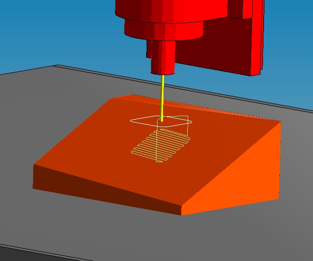

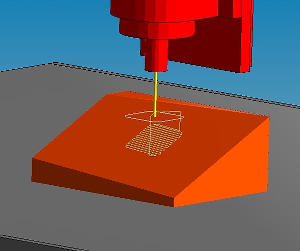

Hello, I just start to use GRBLGRU (3.44.0 and 3.48)
I have done a 2D part correctly
Now, I would like to made a 3D piece of wood.
I try to use the projection mode for do that but it don’t work.
steps:
- import the stl part
- draw a rectangle with the dxf template
- create a jog pocket of the rectangle (with the projection mode)(I have tested different pocket type)
but the result is not correct: the rectangle is not project on the stl part. If I change increment or depth (don’t let 0): it’s the same.
if I change the pocket to cut, the rectangle is correcty project to the stl part.
Could you help me ?
thanks
@L112
First of all, thank you very much for your feedback.
You’re right. This is a mistake.
On my WebSite is a new beta version V3.48.1, with which the error should be fixed.

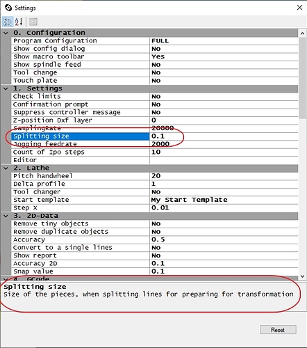

Please note that straight lines have to be broken up into many small sections when projecting. You can change the size of the pieces with the parameter “Splitting size” (default = 2mm) in the settings. A smaller value increases the accuracy, but also the time for the calculation.

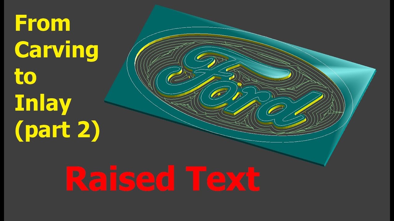

Release notes V3.49
once again I would like to announce a new version of my program.
The attached video “From Carving to Inlay (part 2)” this time concerns the creation of raised text.
The reworked function “Pocket Contour parallel” for machining pockets with islands thus provides the basis for the production of inlays, which however can only be presented in the next version.
Nevertheless I hope that there is already something interesting for some of you.
Have fun with GrblGru

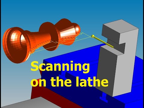

Grblgru, just want if you can help me about the CNC Lathe scan mode. I just put in work a Unimat SL with manual control assisted with CNCN and also the total automatic CNC mode with your great program. I want also do a video but need if is possible reactivate your old choice to the lathe scan surface once also I didi the scan tip and works great but not possible now with your software.
Thanks in advance and all the best.
Giovanni
Beta notes V3.49.9
on my website is a new beta version V3.49.9. it contains the first attempt to make measuring on the lathe available again.
I have made a short video about it. It shows how to measure an STL object virtually. The calculated GCode can also be sent to the controller.
Unfortunately my probe is not working at the moment. Therefore I could not make any tests in practice.
Hi. Really appreciate a lot your collaboration to include again this valuable feature in your excelent program and tool. I appreciate your positive sense to help us to go ahead easily in this CNC world.
Thanks, thanks again.
All the best,
Giovanni

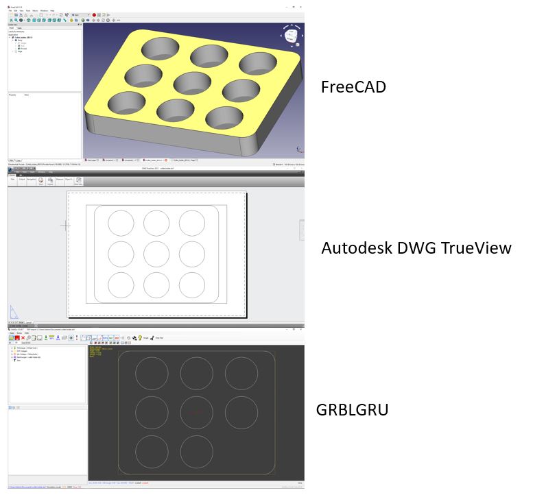

GRBLGRU is awesome - I have though discovered onme issue I dont understand.
When I export a DXF from a FreeCAD model, there seem to be some features missing after import in GRBLGRU. See attached screenshots - I doublechecked the correctness of the DXF in Autodesk TruView, its only in GRBLGRU where there is one of the pockets missing.
