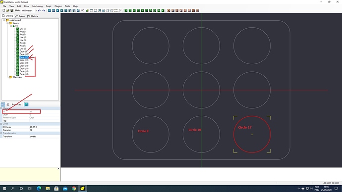

@GrblGru - thanks for the quick feedback. Attached is the DXF. Program version was 3.49.7
collet holder.dxf (2.7 KB)
Hello Roman
I analyzed your file on CamBam, the problem is sequence of object creation.
CamBam generates your reference ID.
See attached screenshot and file.
Armando
collet holder2.dxf (1.9 KB)
Hi, this is interesting. So it seems GrblGru omits the last object created in the model. I had the same issue with three different DXFs and everytime one random feature was gone. Useful to create a workaround and for @GrblGru for debugging
Thanks a lot!

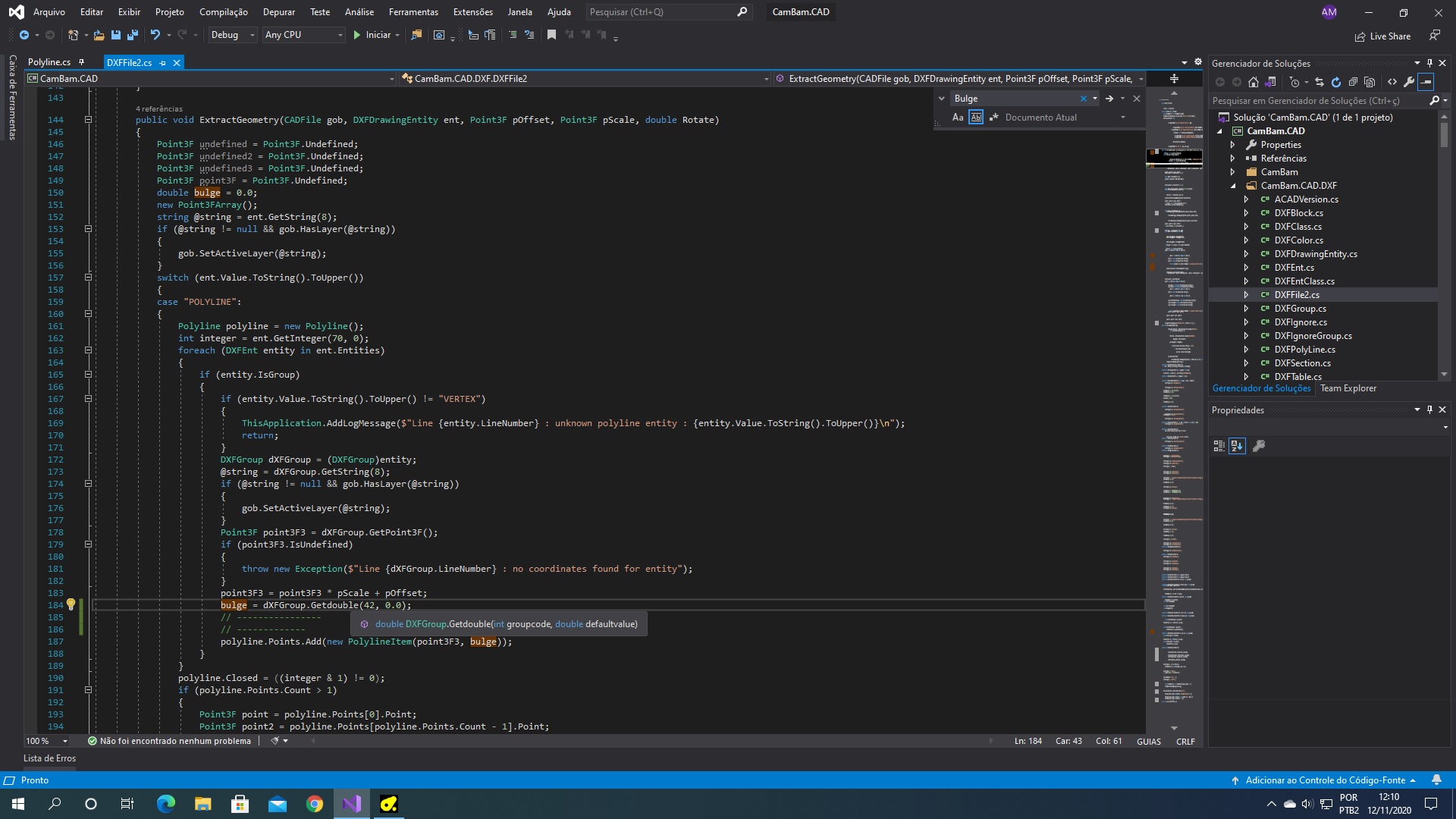

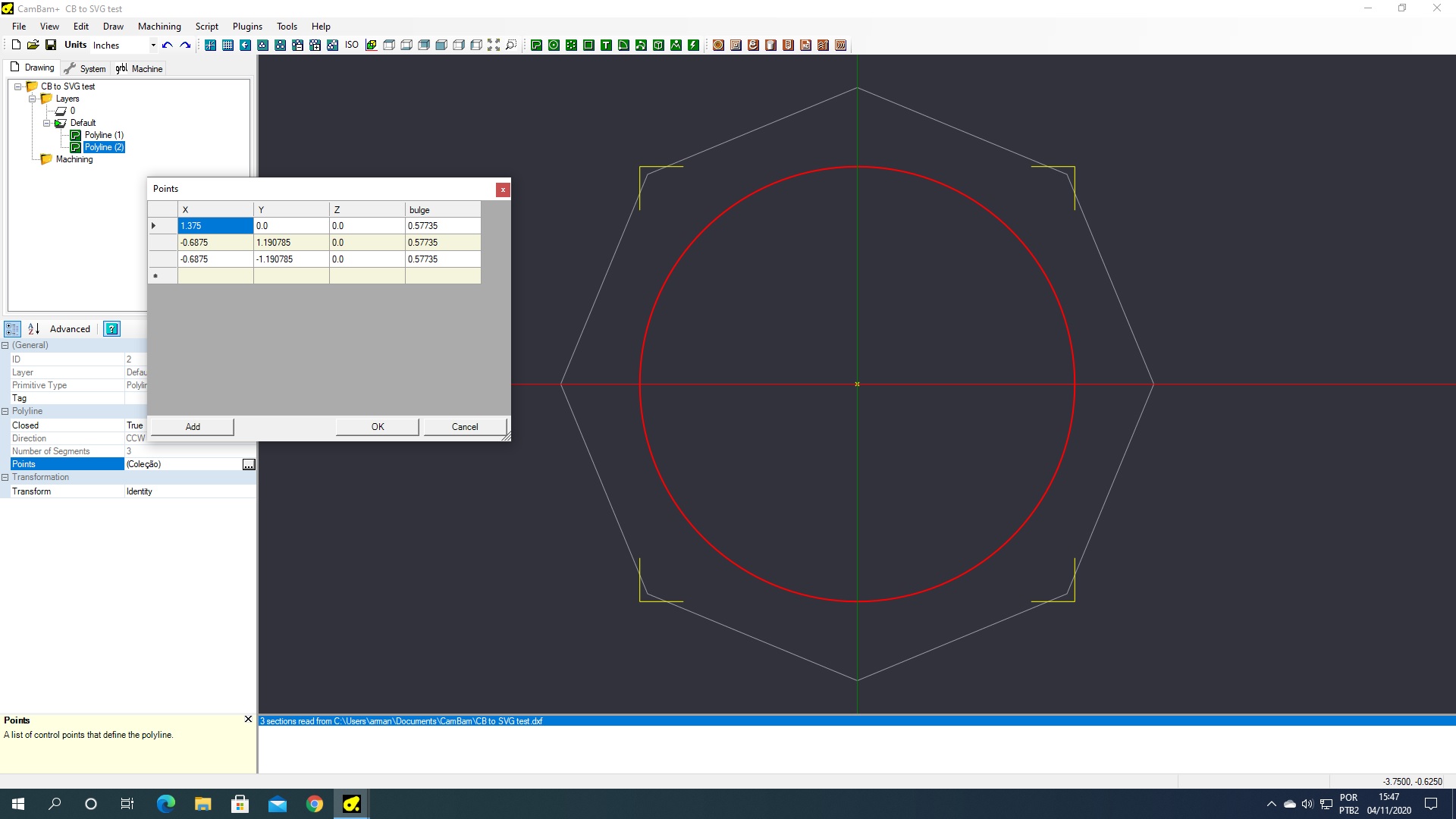

When importing or exporting the DXF file, an element called “bulge” with code 42 is missing.
The math expression is:
bulge = tan (sweep angle / 4)
bulge = heigth / (length / 2)
Armando
Hello GrblGru
Whenever I appear it is to report a Bug.
Attached DXF reference file.
See screenshot of CamBam.
See screenshot of Visual Studio 2019.
Armando
Thanks for your feedback.
But I have not yet understood the problem.
The screenshots are very indistinct. Unfortunately I cannot see anything on them.
Could you please describe in detail what is not working ?
In which program does the error occur ? Do you import a file to GrblGru or export a file to CamBam? Is there an error message ?
Can you provide me with a DXF file that does not work ?
GrblGru
See the file attached here.
Open the file in another CAD program and see the difference.
More information on the cnczone forum.
Armando
CB to SVG test.dxf (1.6 KB)
Ah, now I understand you. ![]()
But I have to tell you that I cannot interpret the complete DXF command set. I do not use a library but programmed everything by hand.
You can see from the amount of the manuals that there are countless commands, some of which are only available for historical reasons. There are also some commands with mathematically very sophisticated functions, whose realization would require a lot of work and time.
The DXF import is only a small subitem in my program and I hope you understand that I want to concentrate on the most important things first. But I will put this item on my todo list.
Thanks for your help
