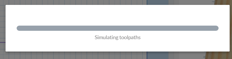

4) Tonight, I am trying to export to an svg, so I can load it onto the 3018 outoboard controller (which runs the file consistently and thoroughly each time I use it). When I click “download g code” I get a “simulating toolpaths” message, and the software just freezes. Attempted multiple times, and it now happens every time.

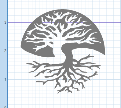

Hey Rob,
Thank you for reaching out. I sincerely apologize for the trouble utilizing Easel during your trial. I was hoping that I might be able to provide some assistance to resolve the issues you are experiencing.
I took a look at some of the projects that you had in your library, and I noticed one project that may have produced a similar result to the cut-off circle issue that you mentioned.
I noticed that the tiling setting was enabled on this project, which is likely the reason some of your carvings were left incomplete or cut off. Tiling is a feature that allows materials larger than the actual work area to be cut via segmented sections/carves. This can be automatically enabled if the material size set in the project is larger than the selected machine profile’s work area. You’ll notice the purple line in the middle of your design area that shows where the tiles are separated:
Because this line cuts off the top of your design, if you only carve the first tile, part of your design will be left out.
I also sent an email to you directly so that we may troubleshoot some of the other issues you mentioned.
I hope to hear back from you soon!
Thanks,
CJ
