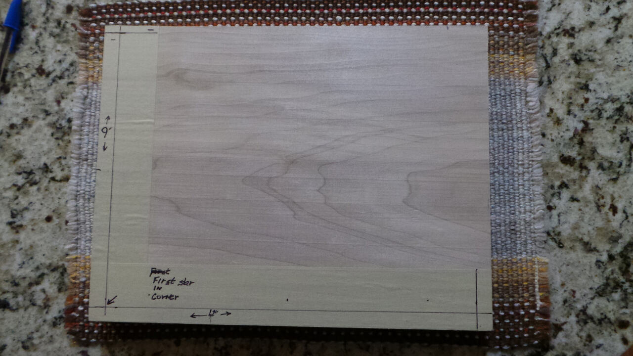

How to set machine to carve stars for an american flag, the overall size of the project is 10 X 13, and the project size is 9 X 12, with the first star starting lower left corner (see Picture)
Hi William - Here is a video I did on making a flag with a union panel about that size. I used the x-carve to do the stars. I included a link to my Easel project as well that may help. Maybe you could just change the dimensions, then Select All the stars and resize them to fit. I used a V bit. Hope that helps, Steve…
