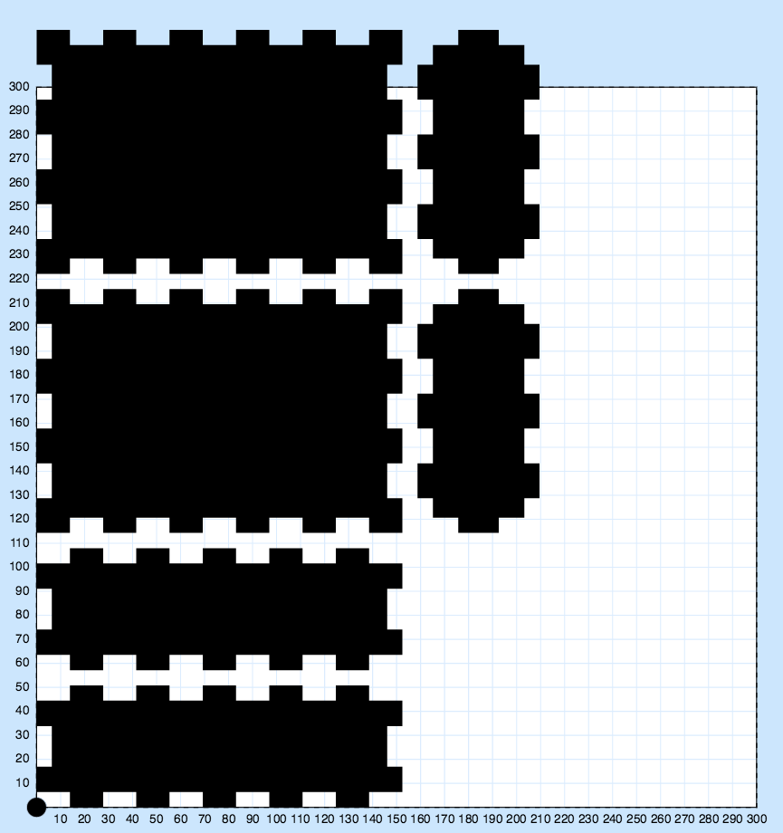

So, we’ll start with a box, using the box generator app.
I set mine to be a 4x6x2 box, .25" thick with .75" tabs.
On my 500mm machine this box is a little too big for my work area, but that’s ok. If you get an error message, hit “cancel” and the artwork will be imported without scaling.

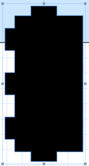

The next thing you want to do is create a rectangle that covers the tabs on one of the side pieces, like this:
It’s important that you leave the tabs on the top and bottom of the shape alone.

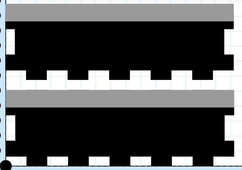

Once you’re happy with the size of the rectangle, copy/paste it for the other box side.

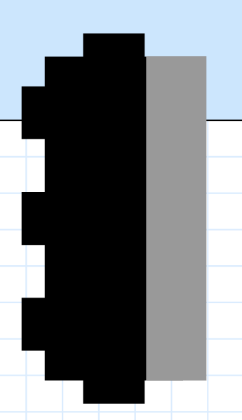

Then, select both the box side shape and your new rectangle and hit Edit --> Combine

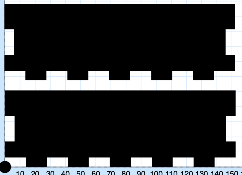

For the remaining sides, you can use the shape’s dimensions and the align tool to make sure the rectangles are perfectly aligned. Once you’ve done that, use the same Edit --> Combine command.
All that’s left is to delete the “top” of the box, reconfigure the shapes for the size of your material, and set them to cut on the lines.
