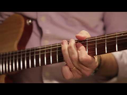

Long story short this video was taken the day we got to film at the Chicago Music Exchange. The guitar being played was made by Chris on the X-Carve.
