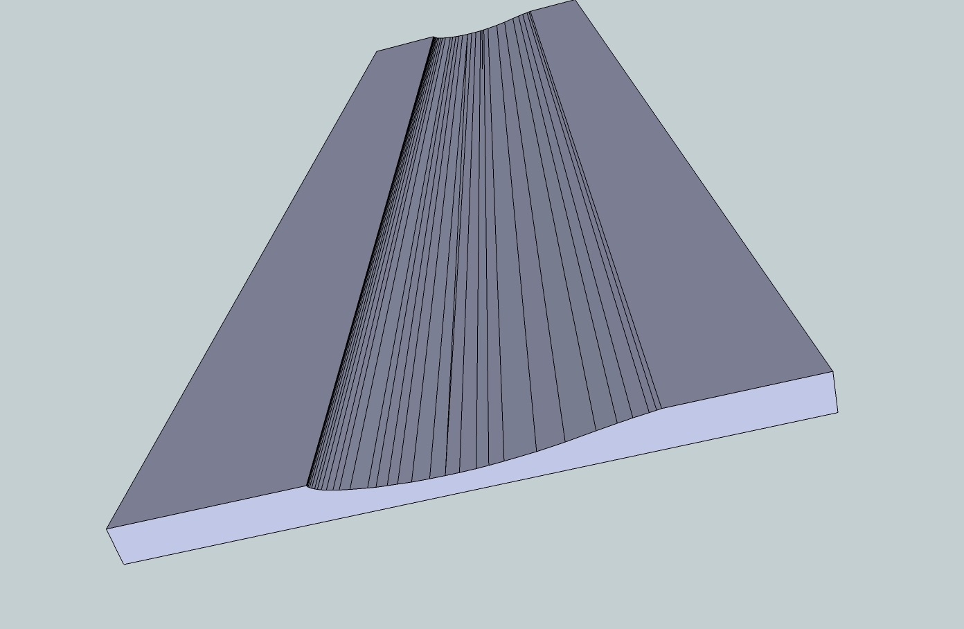

Here are the models I am working with:

I just cut a mold for a lower aspect front wing.
I just made a new fuselage based on my experience that the joints between these parts should be flat surfaces. You can see that the top half of the mold has a flat area to connect to the fuselage.
