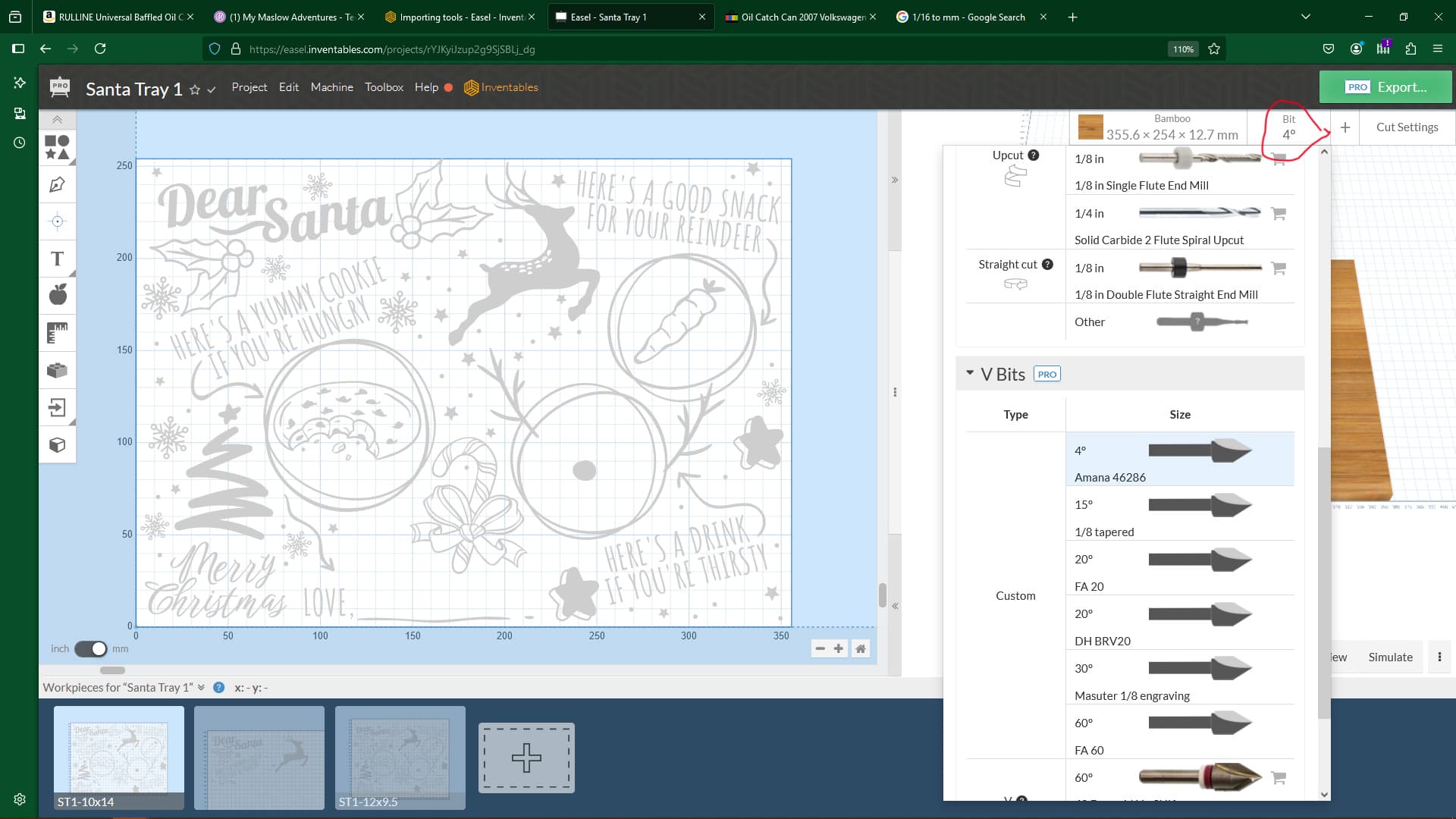

In this example, I have selected a 1/4" bit, which is much too big to do the details, and as you can see in the preview window, it is only going to carve a small part of the job.
You cannot select a bit from within the toolbox. It must be selected from the ‘Bit’ dropdown on the toolbar.
You can see that I have added your bit to my toolbox, and it appears in my bit list so that I can select it from there. If you cannot see your bit in that dropdown list, you may need to add it again. I did have a problem trying to set the angle, Easel does not accept decimals in the angle, so you have to specify a whole number. It won’t take 3.6 degrees, so you would have to choose either 3 or 4 as your angle.
