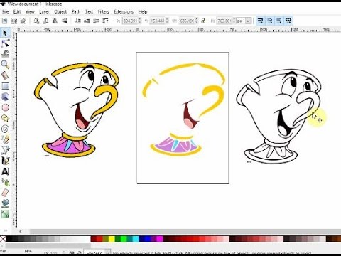

Just got back and see all this. @RussellCrawford when you convert an image that has multiple colors such as this and you only want a solid color choose the colors options under the second choice of multiple scans, then in the scans dialogue set the number to whatever has the clearest image (I always have live preview checked).
then when you create your image select your new image and click on ungroup under the menu option oblect. then you can select each layer (which is one color) and space them apart and choose which one has the best image trace. (sometimes it is a light gray one or some other color that you did not even expect) delete all the layers that you do not want and work with the cleanest layer to refine to your taste.
here is a youtube video that shows the steps
Russel, I select “Colour”, uncheck “Stack scans” and limit “Scans” to the numbers of colur I want + 1. Since this is a black/white scan I set “Scan=2”.
I then delete the original artwork and delete the background layer.
Save as SVG

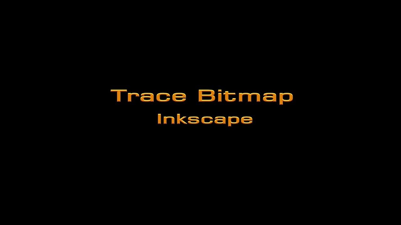

Download image.
Open in Inkscape.
Select image.
Right-click --> Trace Bitmap (default settings will work), click OK.
Move trace to the side.
Delete original image.
Save as (give the file a name)
Import into Easel.
You can (crudely) trace image directly in Easel, using Image Trace app. This is the absolute simplest method, but it has limitations and depend heavily on an appropriate source image for clean trace.
Your Pine-tree image is a clean B/W image well suited for tracing.
For greater control of output, Inkscape is really good and using only a few of its elements goes a long way, but the initial learning curve may appear steep.
Here is a video showing the steps, plus more on how to manipulate the nodes - skip that for now and focus on how to convert, save as SVG and import into Easel first ![]()
