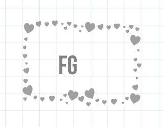

Here’s the jpg I’m trying to work with. I’m carving a plaque for someone and this is what they gave me to work with. (obviously the lower left text needs removed)
Hello Dean,
I traced the image in InkScape and it didn’t do good, I imported the image into CorelDraw and it came out better.
Here is a quick Inkscape convertion:
