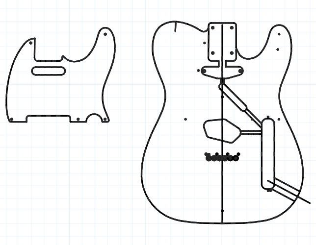

all these parts I have drawn are basically all separated lines with separate nodes.
is there a way to combine all of them? I want them to be a fill not an outline.
did you tried selecting all of them and combine? right click and select combine,
Make them all solids first then combine then you can switch back to outlines.

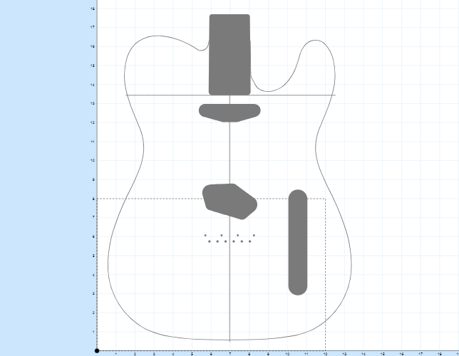

i have the pickup routes, neck pocket and control cavity in an easel project, but without the wire channel. i never use them, so i didn’t design them in
(edit) if you’d like them, i mean
complete with screw hole starters for the bridge

It looks like the lines on your original post are not continuous or there are broken segments. If you want to post a share to your project file, I could see if that is the case.
they are broken segments. that’s why I’m trying to combine them. I’m lost!! ![]()
did you import a drawing or did you make it in Easel?
Currently, Easel can combine closed shapes but not segments.
edit* You have to share your project under the file menu and click save before I can open it.
the drawing was imported. it was taken from a pdf blueprint and saved as an svg.
clicked save!
Do you have access to a vector drawing program such as Illustrator or Inkscape? You need to join/weld your segments first before importing.
ok. that makes sense. I do use inkscape. thank you!
I looked at your project and the rest of the shapes have the same issue. None of them are joined. You’ll run into the same issue of trying to set the cut to an outline.
