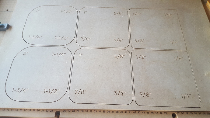

OK, i did this and threw my last deign into Easel. It went from an hour-16 minute carve, to 7 minutes. Thank you.
I figured out a system, i draw everything up at work, save it as a DXF file to a flash drive and bring that home to Inkscape.
The other question, how do I tell the system to do the type of cut? Do i need to hatch in the objects in AutoCAD when drafting them?
It’s carving now, forgot to set the tabs on the lines. now there’s about 32 tabs per piece. Live and learn.
This makes a square in 4 pieces. how do you join them for a continuous shape?
