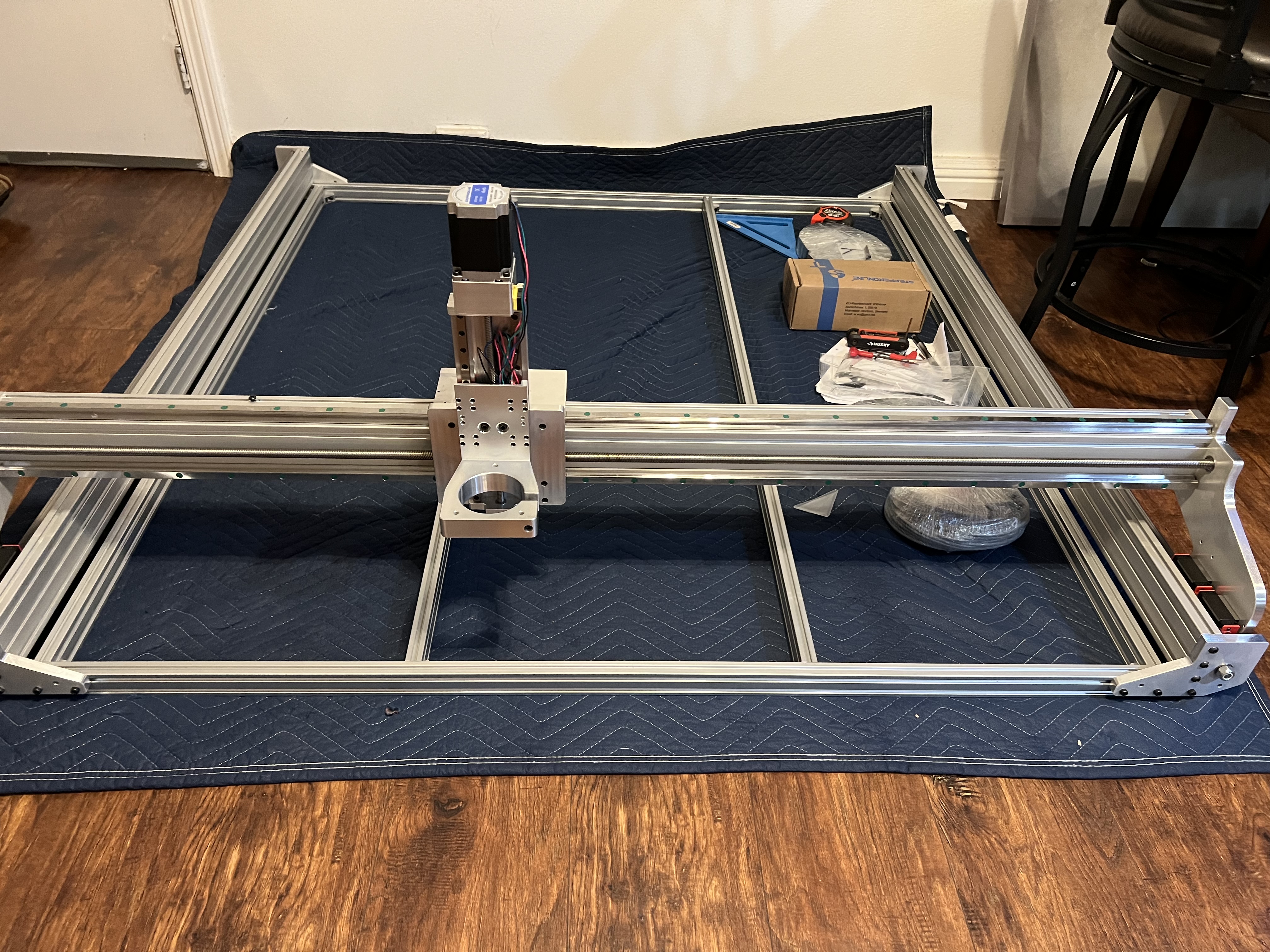

I got me a new machine 51”x52” working footprint.

I think if you change $130 and $131 to the new size, you should be good.Perhaps go through set up and select a different machine?

I did it and the gcode came out when I downloaded it.
Yes, you can set up a custom size for your machine and create designs without having to tile. I have a 4’ x 8’ machine, which comes out to something like1220mm x2440mm.
