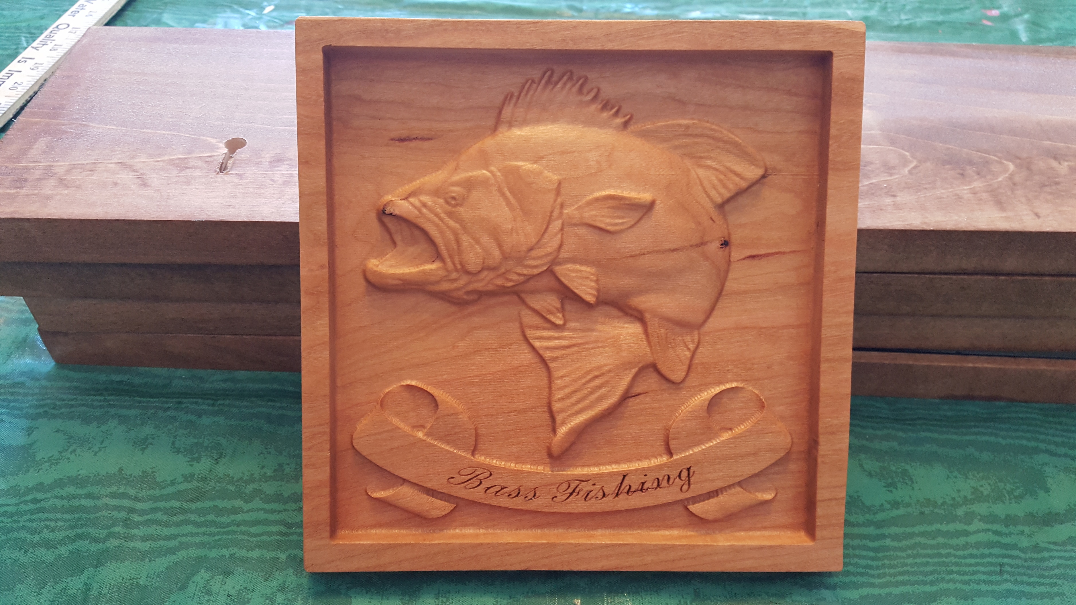

Any idea what this is worth? Done on an 18" edge glued pine.
About 22hrs to complete

Looks good! 22 hours…WHAT?!?
Looks really great, but did it really take 22 hours to carve? You should be able to go faster than that, especially if you do a roughing pass with a bigger bit.
doesn’t even need roughing.
parallel finishing at 1500mm/min
30 minutes tops
30degree .004 flat engraving bit, 50% stepover (.002) @ 160 ipm.

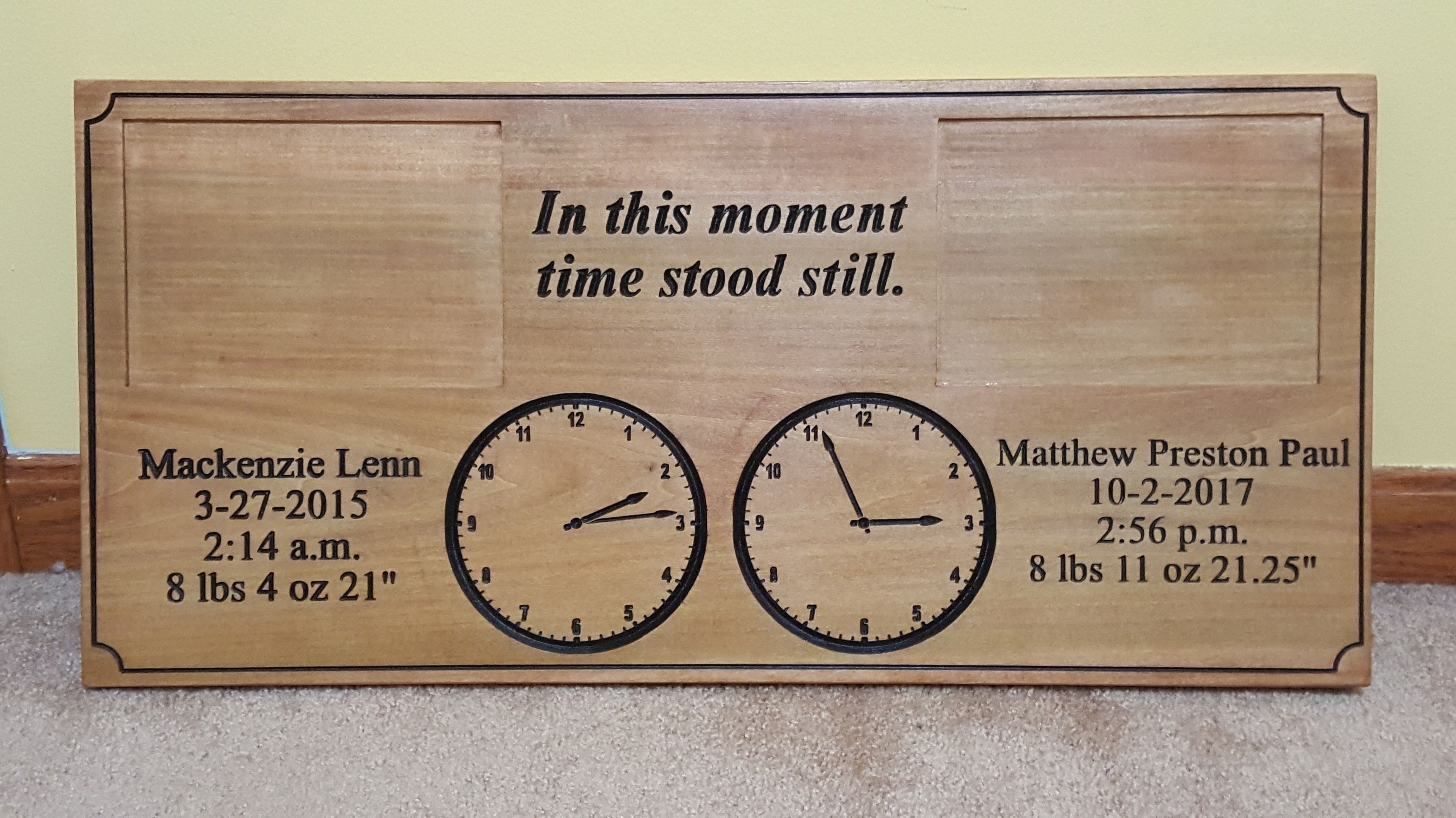

what is your process?
I’ve been sealing with minwax poly seal and then painting the letters.
But I still struggle with bleeding.
