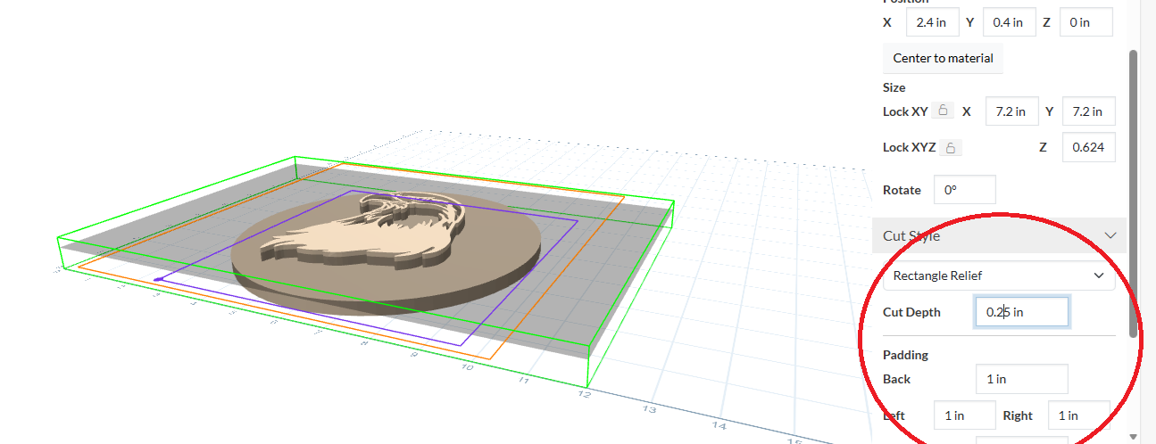

I have an american flag in back of a bald eagle head. I don’t want the flag that is behind the head to show or carve. How can I achieve this? I put the eagle on top layer and the flag behind and I get a mess. Any help would be appreciated. Thanks
Try setting the depth of cut to zero.
Adding to what Ron said, when you make the choice of depth of cut for the toolpath, you can adjust the depth to only cut so deep by sliding the scale. This should show up in the visualizer, so you adjust it to what shows is what you desire to end up with. I don’t have pro, so I can’t really show you without playing around. You can adjust cut style.
Watch this:
Easel Software Troubleshooting: 3D Cut Depth
