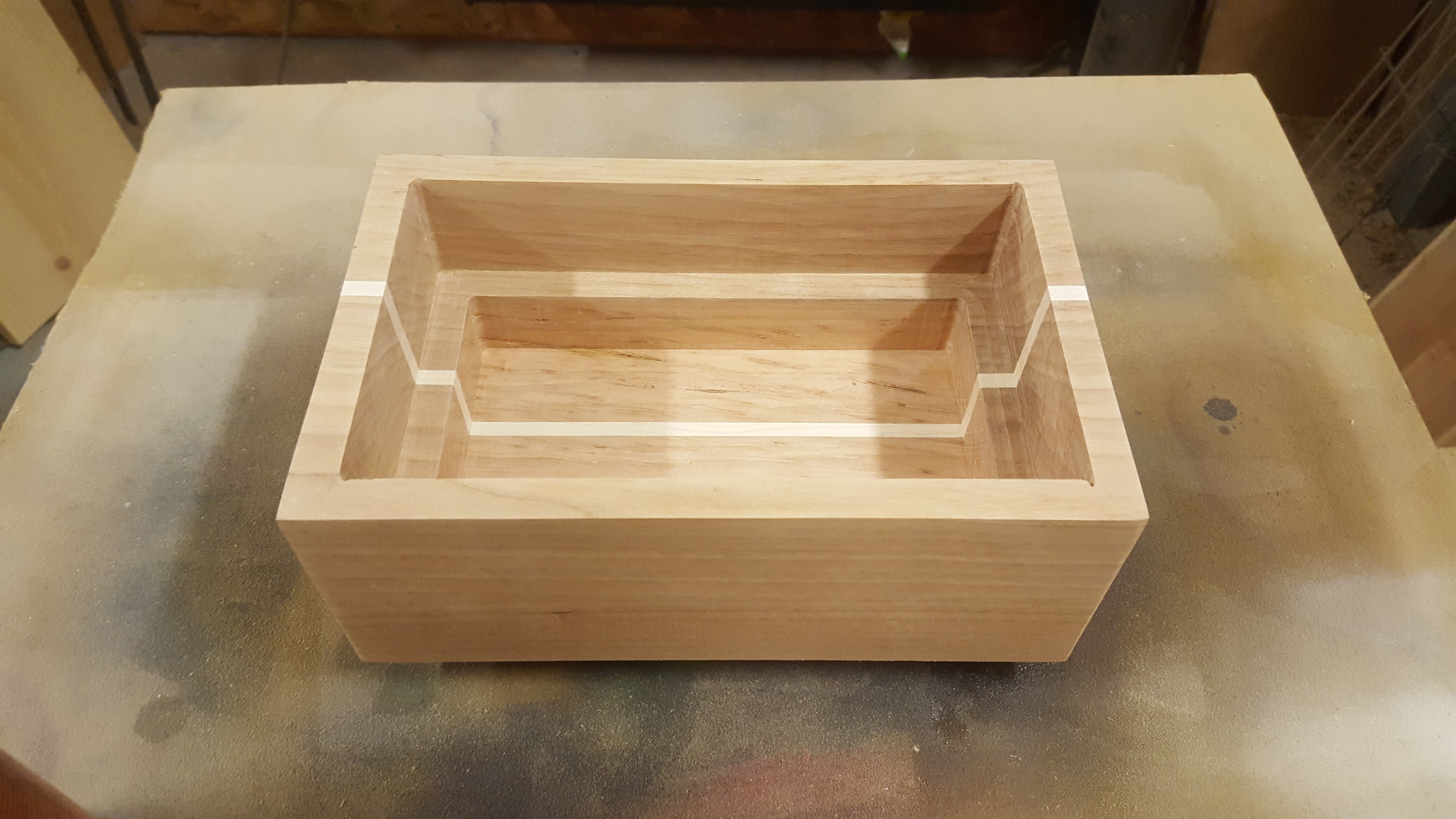

In fact, I just carved out a Cherry and Maple jewelry box 3" deep.
