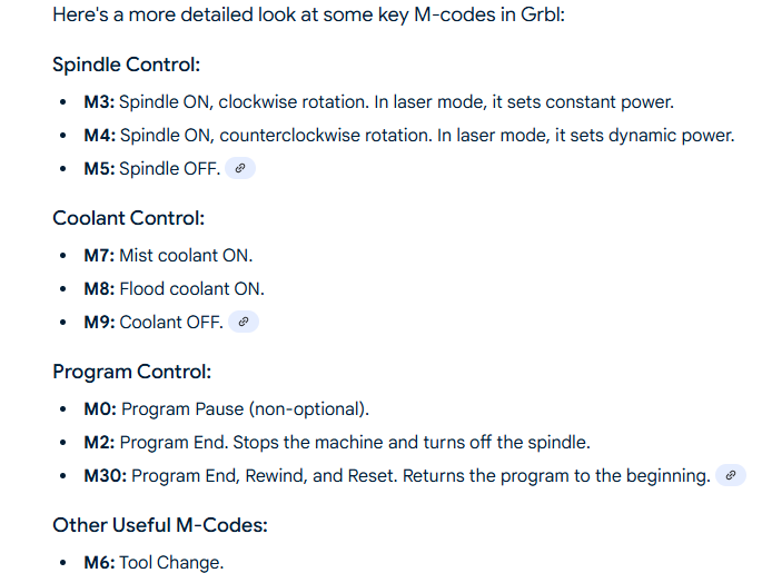

How about removing the problem holes and copying them into their own separate gcode file. Then run your program and go back and run the hole making program. You could then just tie the two gcode files together into one long one.In a text editor, copy and paste the second file below the large one. You could stick a pause in between them to change bits while the x controller is on.Use a1/4 bit with the hole drilling app or use a 1/8 bit with clear out cut.
You could stick an M5 at the end of the Easel program 1 assuming it goes back to 0,0,0 and pauses. Then you’d make your bit change and then start program2. I do this all the time.M5 and M30at the end of the gcode stops the spindle and…ends program.
