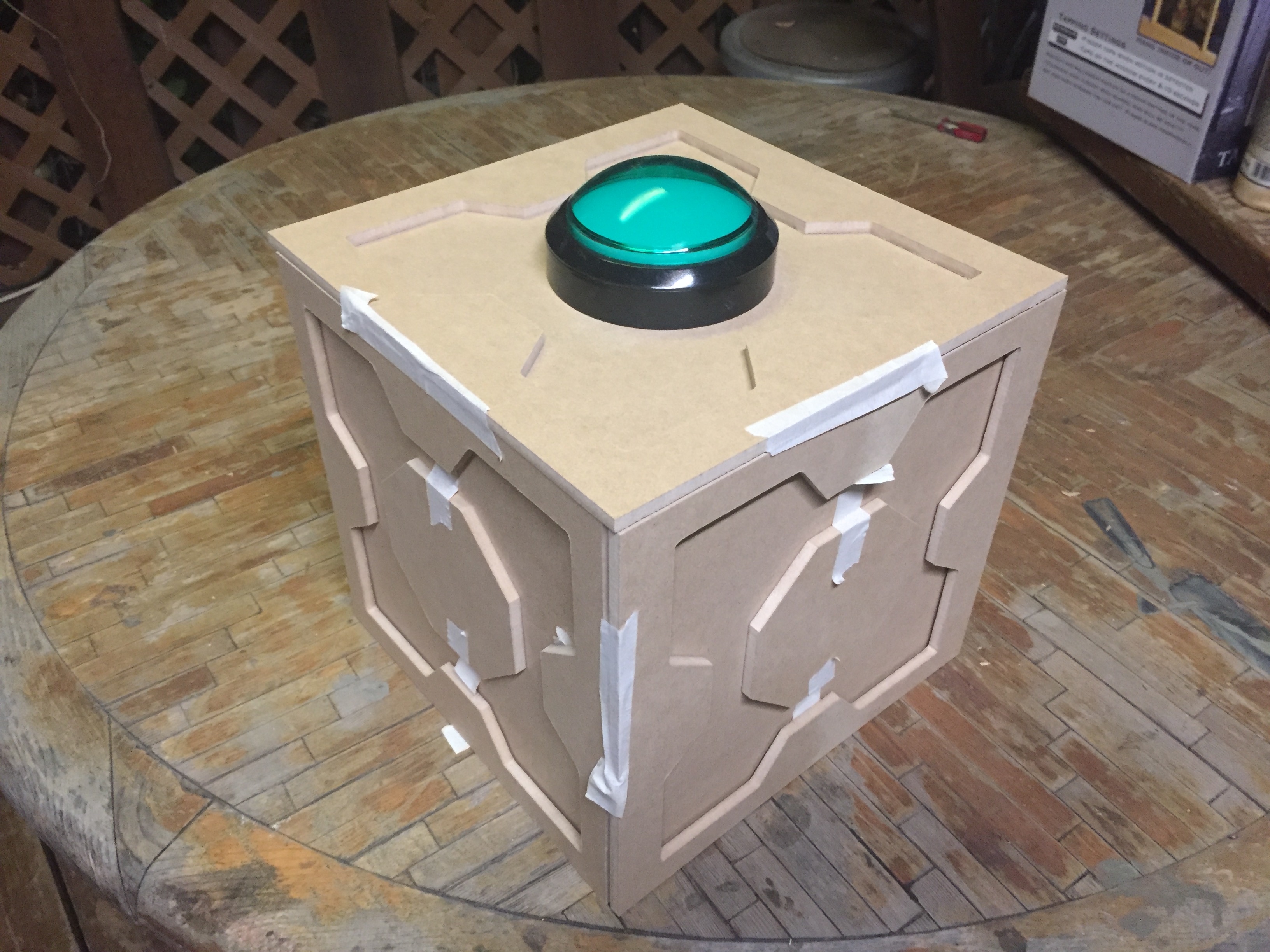

I decided to do a 2 layer carve in 1/4" MDF.
The base box with dovetails and a decorative layer on top.
I did it all with a 1/8" downcut bit
The basic box dry fit with tape
There is a button! I must push it
The final project:
It lights up
This was a pretty quick carve. I was lucky and all my math worked out. Especially with having the decorative layer edges overlapping.
I think later I will revisit this project. I would like to use a v bit to miter cut the edges of the decorative panels so that they have a nice clean edge.
I also want to redesign the bottom so it can be easily opened to wire up speakers so the button says things from the show when pushed. Right now the bottom diamond is removable, held in place with screws, which works fine for changing the button’s batteries, but it is a very small access and a bigger panel would be ideal.
