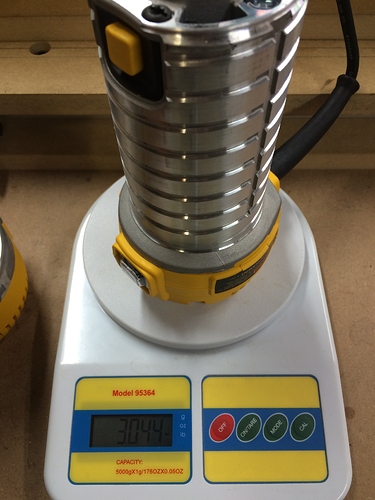

Here are a few weight figures.
Thank you to @sketch42 for weighing his Makita.
Here is the Dewalt DWP611. It weighs in at 3.05lbs. This is 0.25lb lighter than the Makita
Here is the weight of the DW616 (witch accommodates a 1/2" collet). Weighing in at 5.3lbs
Here is the difference in weight between the 611 and 616. The 616 weighs in at 2.25lbs more than the 611. The weight of the 618 is 1.75 times greater than that of the 611.
Edit: I failed to mention that the Makita was weighed With its Collet and Collet Nut. Where as Both Dewalts had the collet and collet nut removed while weighing. This will accomadate for a slight amount of differences in weight between the two.
