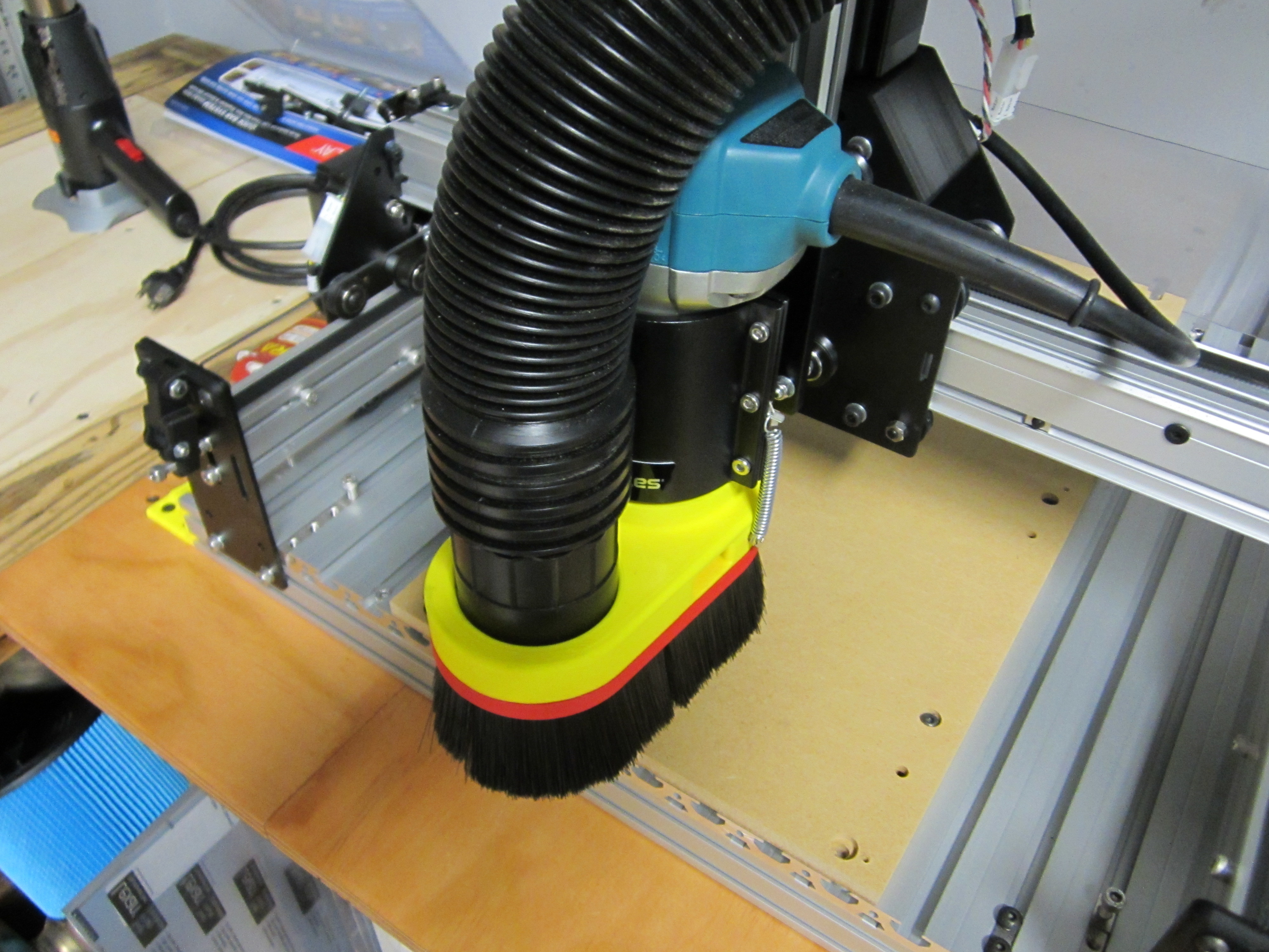

I present to you, the MShoe.

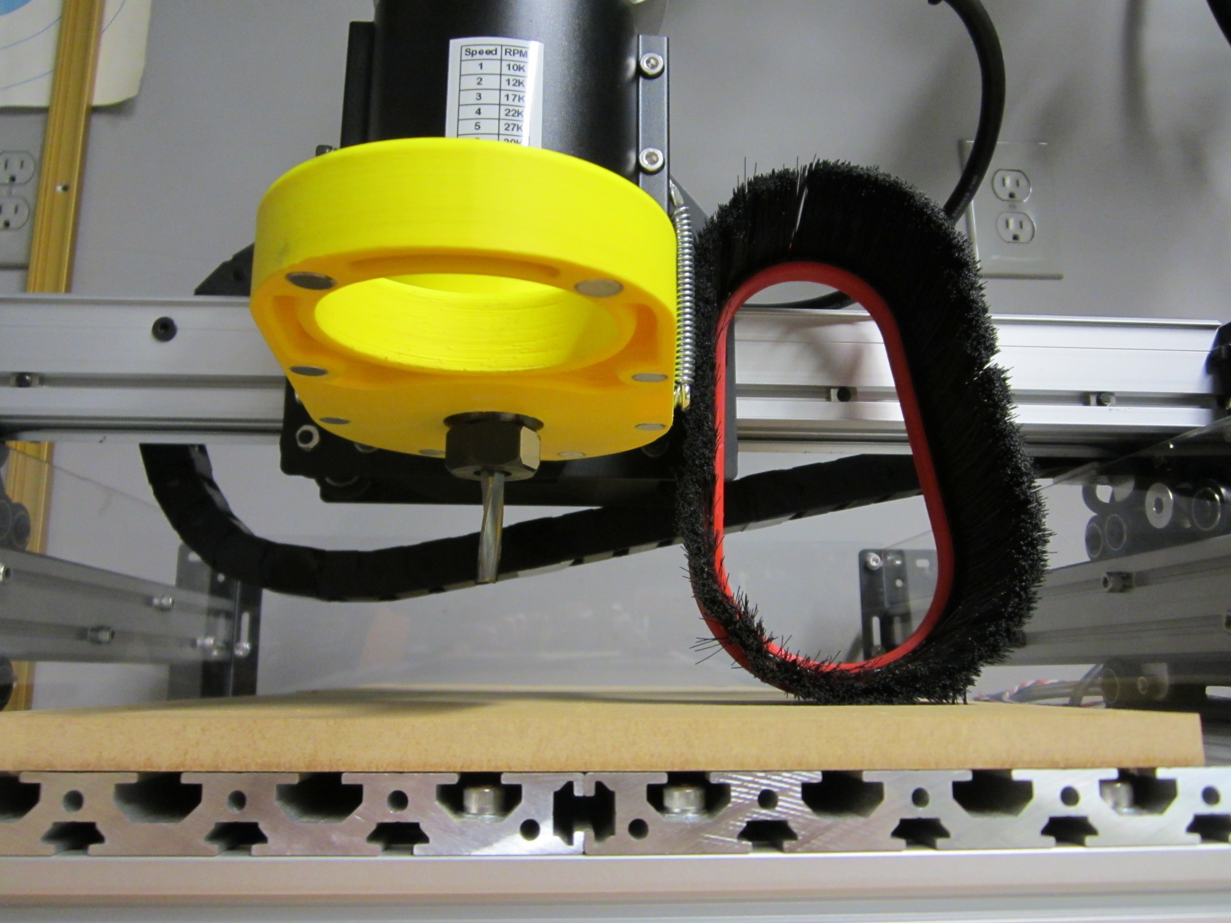

The upper part features channels to deflect the router air off to the sides. It accepts a 2.5 in Rigid shop vac hose. There is a small notch that keys into the router body to prevent the shoe from rotating around. I have mine mounted via a couple of springs along the sides, but a single strip on the left side could also be used. On the bottom there are 8 small recesses for magnets. I used some ¼” magnets, that are actually closer to 8mm, I found at Hobby Lobby (http://www.hobbylobby.com/Crafts-Hobbies/Basic-Crafts/Magnets/8mm-Power-Magnets/p/74984). They are about 3.5 mm thick and they are held in with Go2 Glue (http://www.loctiteproducts.com/p/go2_glue/overview/Go2-Glue.htm). It has some give, like a really thick caulk, which I thought might be better at resisting the impact action of attaching and removing the lower part of the dust shoe. Also it makes it possible to pry the magnets out so they can be reused if the dust shoe needed to be replaced. Other glues such as CA (Super Glue) or Elmer’s School (PVA), or wood glue could be used.

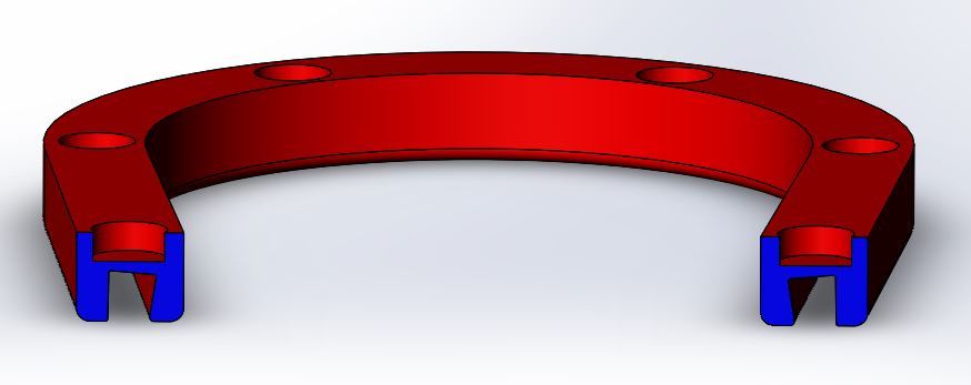

The lower part has matching contours and magnet recesses. Mainly it features a channel for holding the brush material. I used the McMaster Carr Easy-Cut Strip Brush 2” PN 7900T5. No glue or fasteners needed. Simply wedge the brush into the channel and push down firmly on the rubber edging with a flat head screwdriver to push it completely down into the channel. The channel also cants the brush at a 5 degree outward angle so the brush nicely spreads out against the workpiece rather than bunch up or under the dust shoe where it could resist downward travel or get pulled into the bit.
