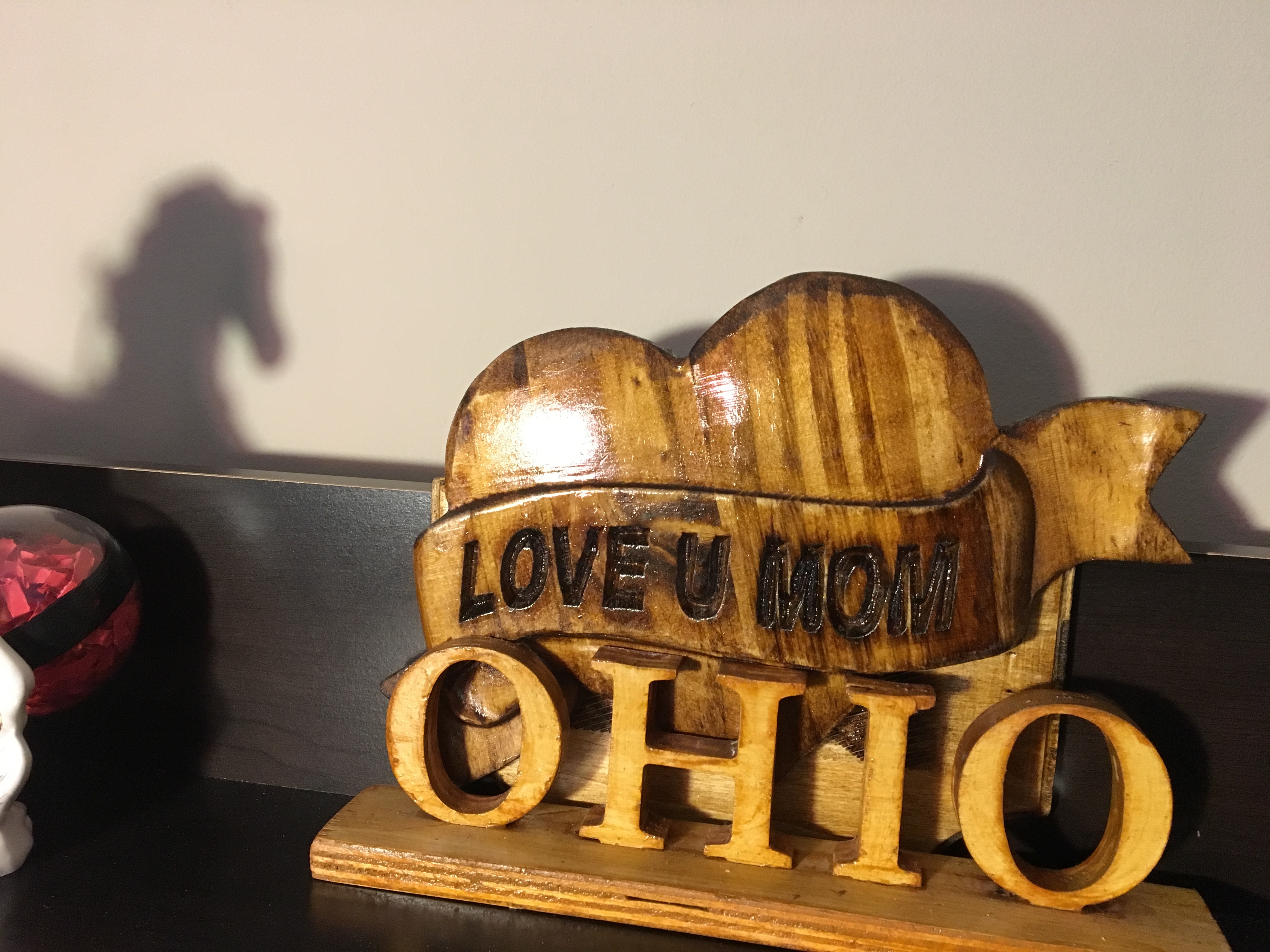

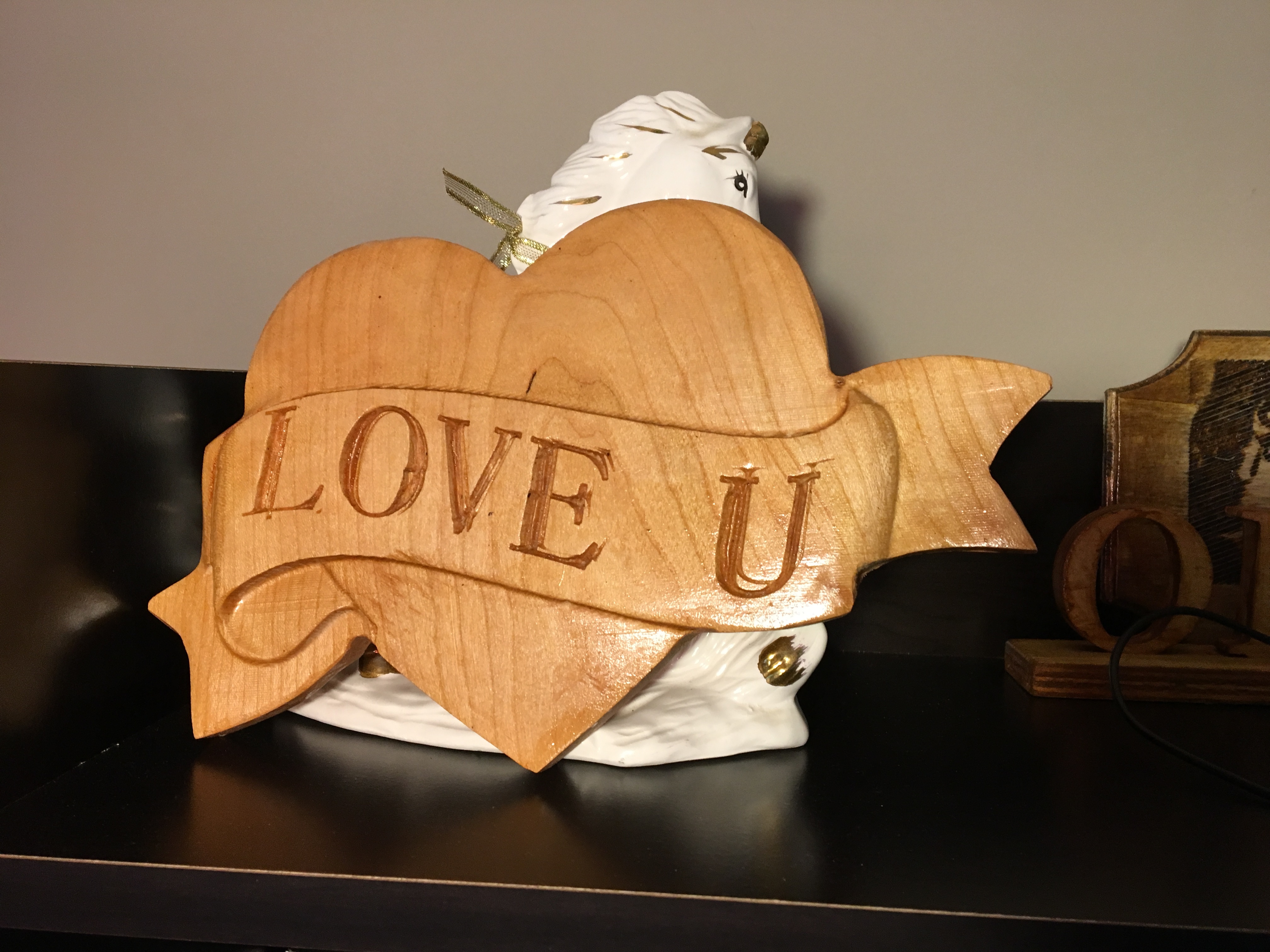

I used vcarve pro to carve this model , only use finishing without roughing, I used 1/8" bit ball nose
Nicely done!
Yes I bought vcarve pro 8.5 and started to carve 3d models I want to give a shot for my website because last time you do not like it
I want you to see it again and tell me what you think
Www.7handcraft.com
