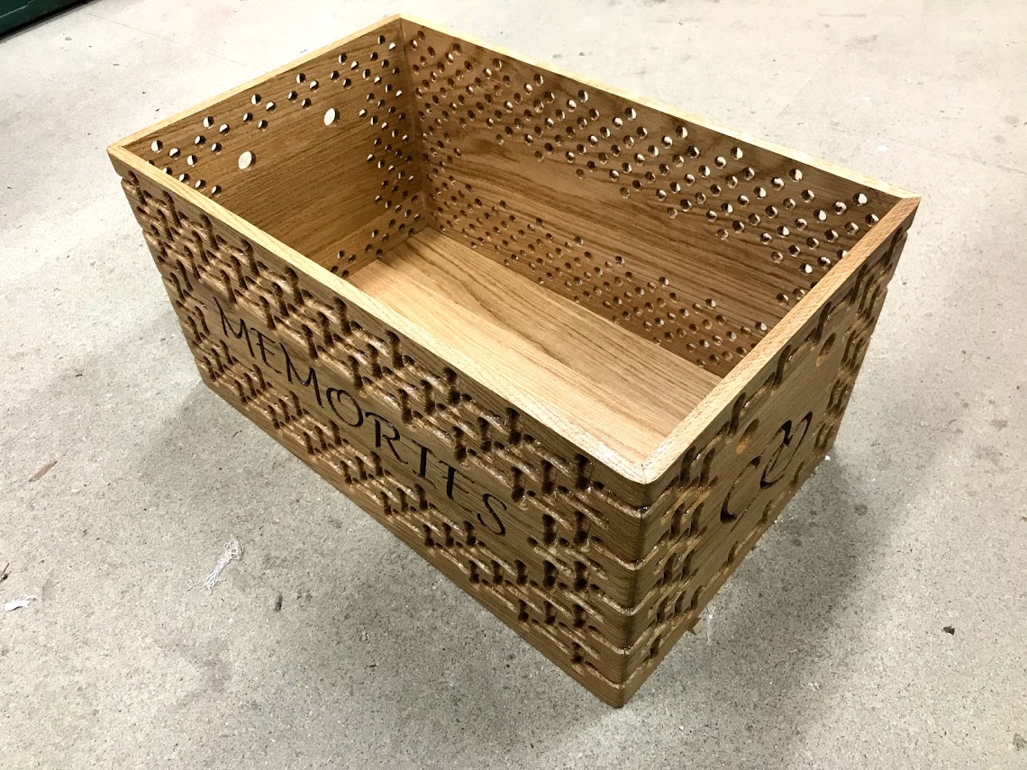

Hi all, I am reaching out as I am part way through a project and am struggling with the final part. I have designed and created a keepsake box that will incorporate wood and rope.
As you can see I am at the stage where I need to choose a path for the rope that has a fixed route on the outside of the box and a yet undetermined route on the inside. I would like the inside to look pleasing to the eye and not cross over to maximise the space available in the box. I will start and end each piece of rope with an oak bracket which grips the rope on a solid part of the box.
The above illustration shows the rope path on the outside. I have tried drawing the inside path with a sharpie to no avail. Perhaps there is a mathematical solution to this or if anybody has any ideas for a starting point it would be much appreciated.

Why don‘t you go all vertical through all lines and after the last line go around the horizontal lines ore vise versa?

No matter what, there will be diagonals and crisscrosses…what about installing some sort of lining to hide it?
I don’t want to hide it, I did consider this for a very short time but like the idea of seeing the raw nature of it. I am more than a little OCD and would at least want some symmetry. I tried all vertical and horizontal and doesn’t seem to work either.
Didn’t even think for a second that this would have been difficult at all so didn’t give it a second thought. Live and learn i guess
came up with this for the lid, quite happy with it. The circles are the ends of 2 ropes where there is space for the end brackets.
I will experiment with that, the rope is 8mm and I don’t want the inside box part to be too large. Also don’t want there to be any visible difference on the outside of the box.
