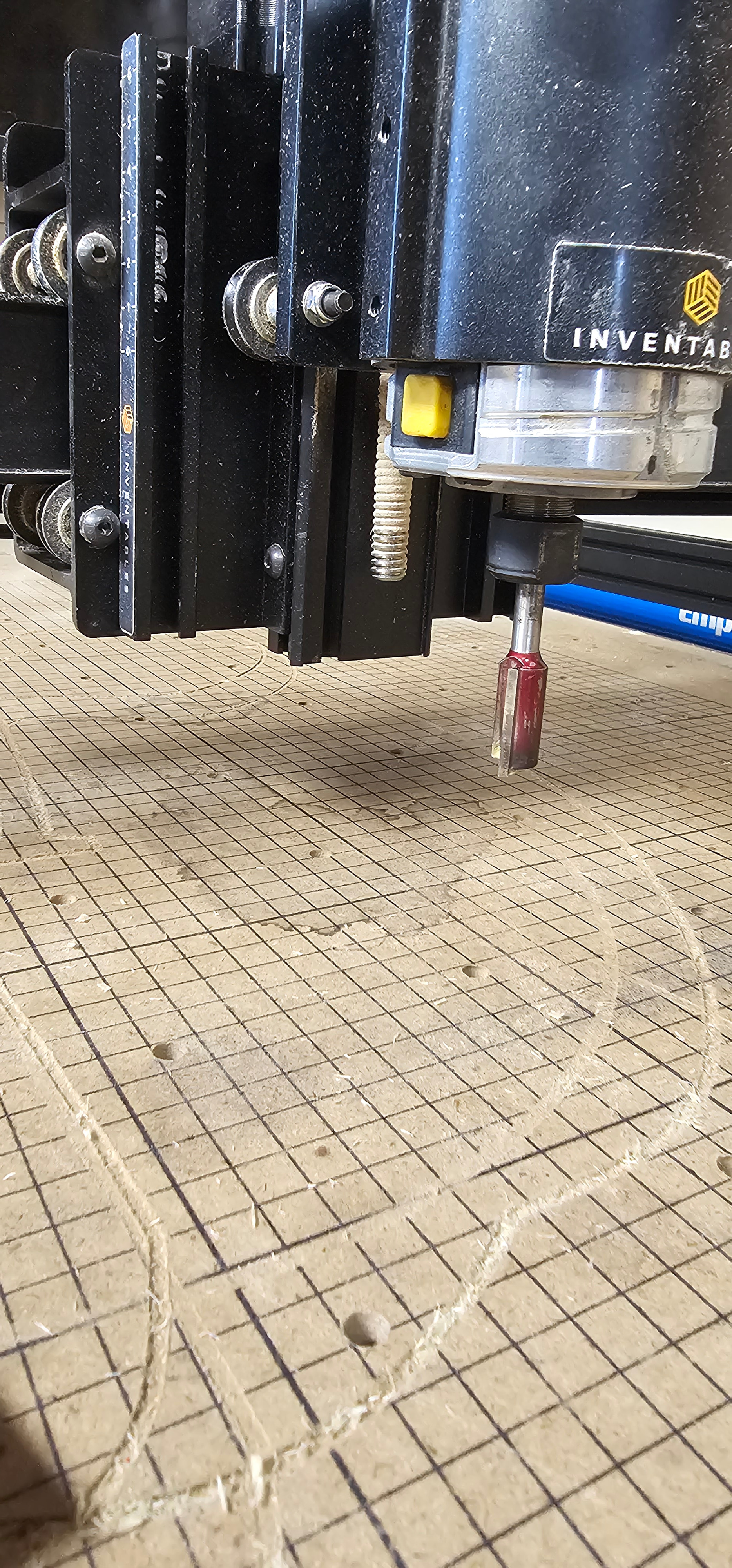

I bought it used very nice condition I noticed the part that holds the router is mounted as to where it sticks down past the rail 1/4 inch. if this normal?
If you post a picture of it, we might be able to tell you.
see it it is about 1/4 inch below the back of it
that is adjustable see the link
X-Carve Instructions: Attach to X-Carriage
