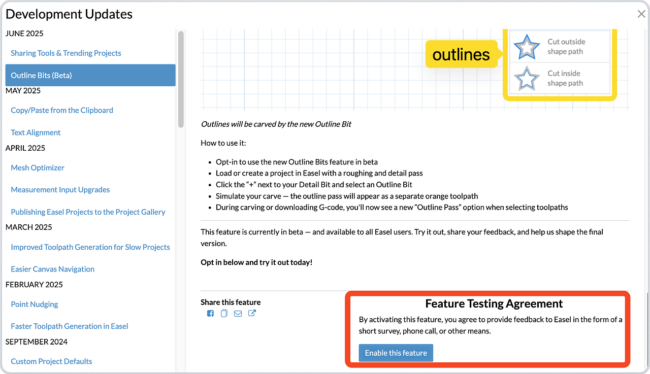

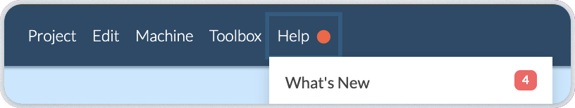

Hi @Nick14, to access the Outline Bit feature, log into Easel and follow this link:
Another way to access it is by clicking What’s New under the Help menu:
At the bottom of the feature description you’ll find the Testing Agreement. Click “Enable this feature” and you’ll have access to it!
Thanks for giving it a try. We look forward to getting your feedback.
